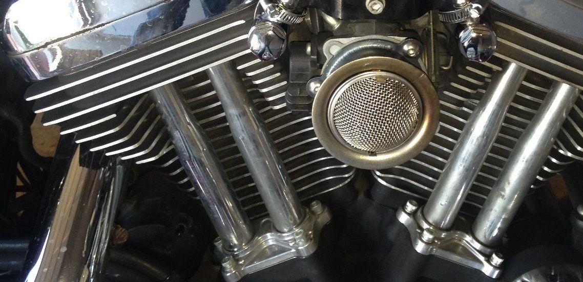

Originally Posted by Slayor$
... to give her more room for her knee to clear the AC. Does it give you more room? Is a new tune necessary on a fuel injected bike? ...
Here's yet another option. This gives my right knee more room. And because I didn't radically change the exhaust, I didn't need a new tune:
It's a DKCustom stack (with screen & filter) BTW.
