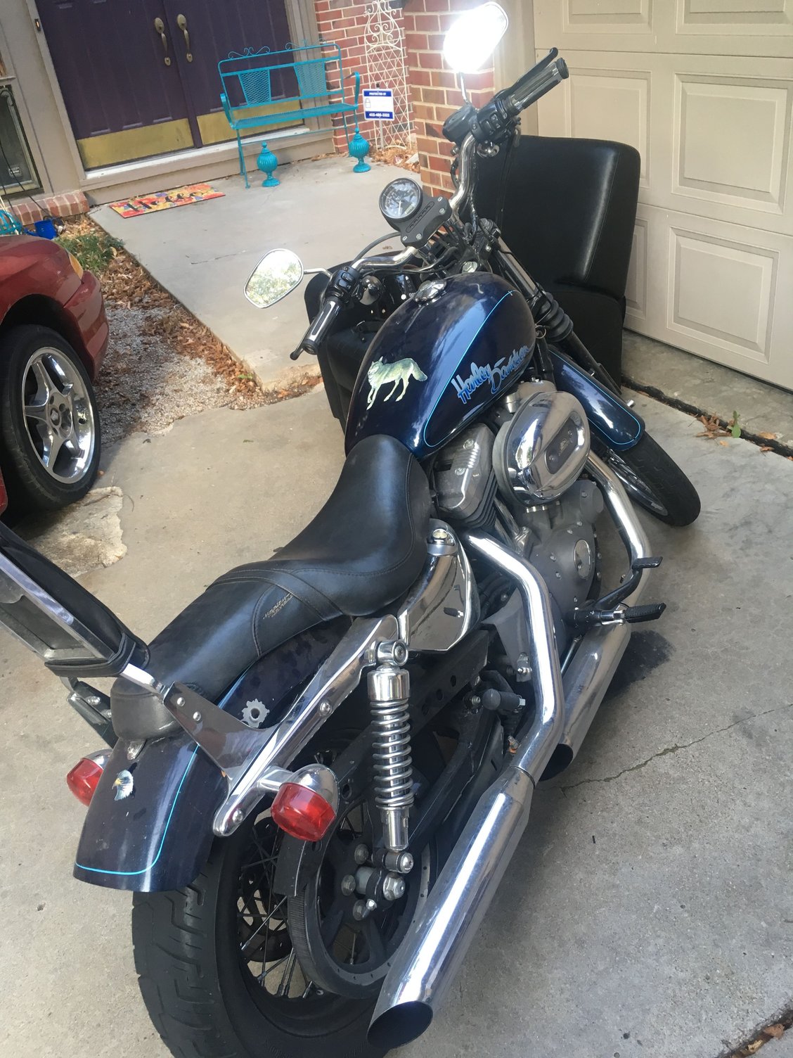

Thank you! When I first saw this bike knowing it was a Nightster, it took me a while to try and sort out what happened to it. It appears that it was a theft recovery that was rebuilt using a lot of 1200c parts that must’ve been leftover from someone’s project. I’m gonna try to make it my own more in the vein of the original Nightster.

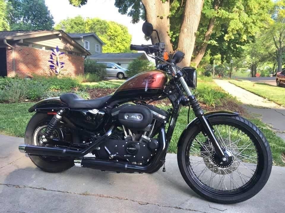

Here’s the final product!
