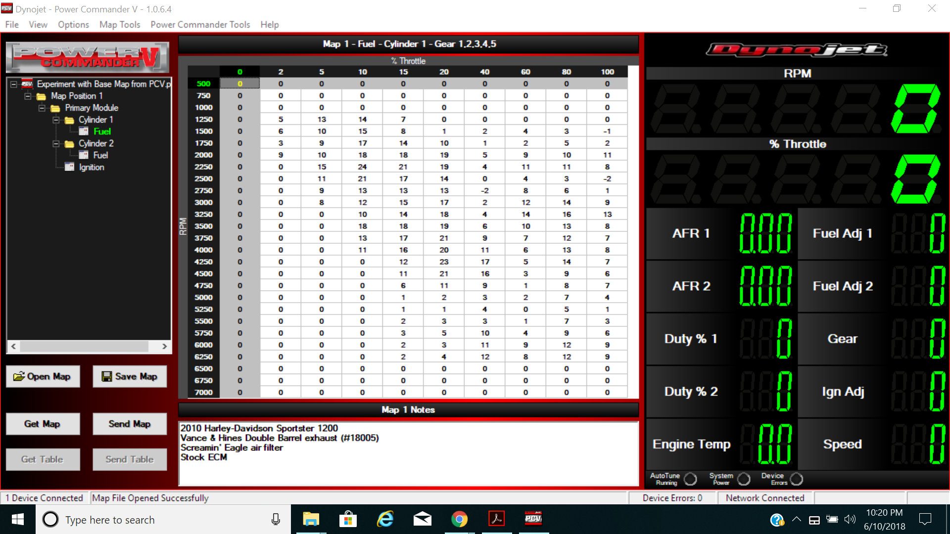

This is the update so far after being in and out of town and wrenching on the weekends.
While I had the PCV and having high idle, never had any error code. I replaced the IAC, no error codes but intermittent high idle.
Today, I removed PCV and cranked the bike. After a little hesitation, bike started up - low idle and white smoke. I let it rev a bit and after it settled, it was still low idle. I got the error codes P0113, P0118 and P0123. Before I throw parts at it (TPS), I want to start with replacing the battery.
Any ideas or suggestions are welcome. Thank you.

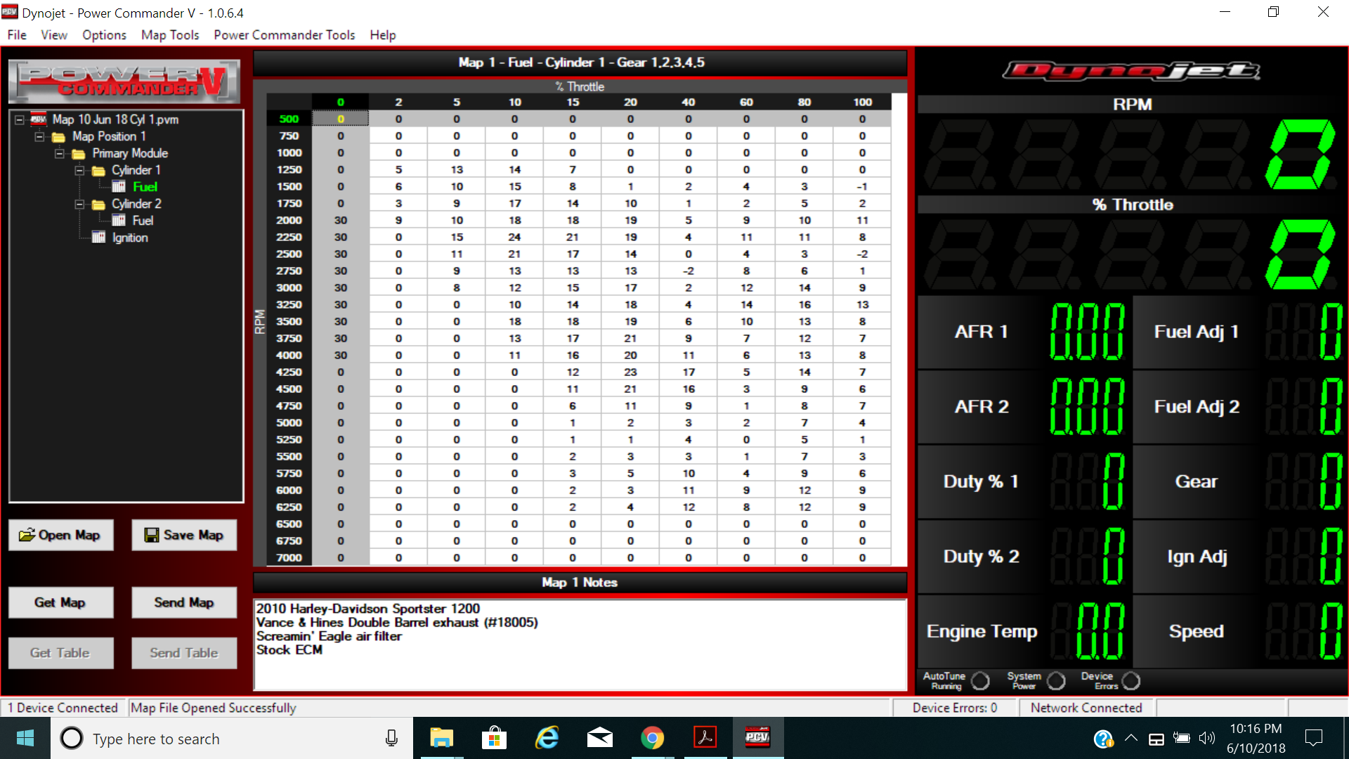

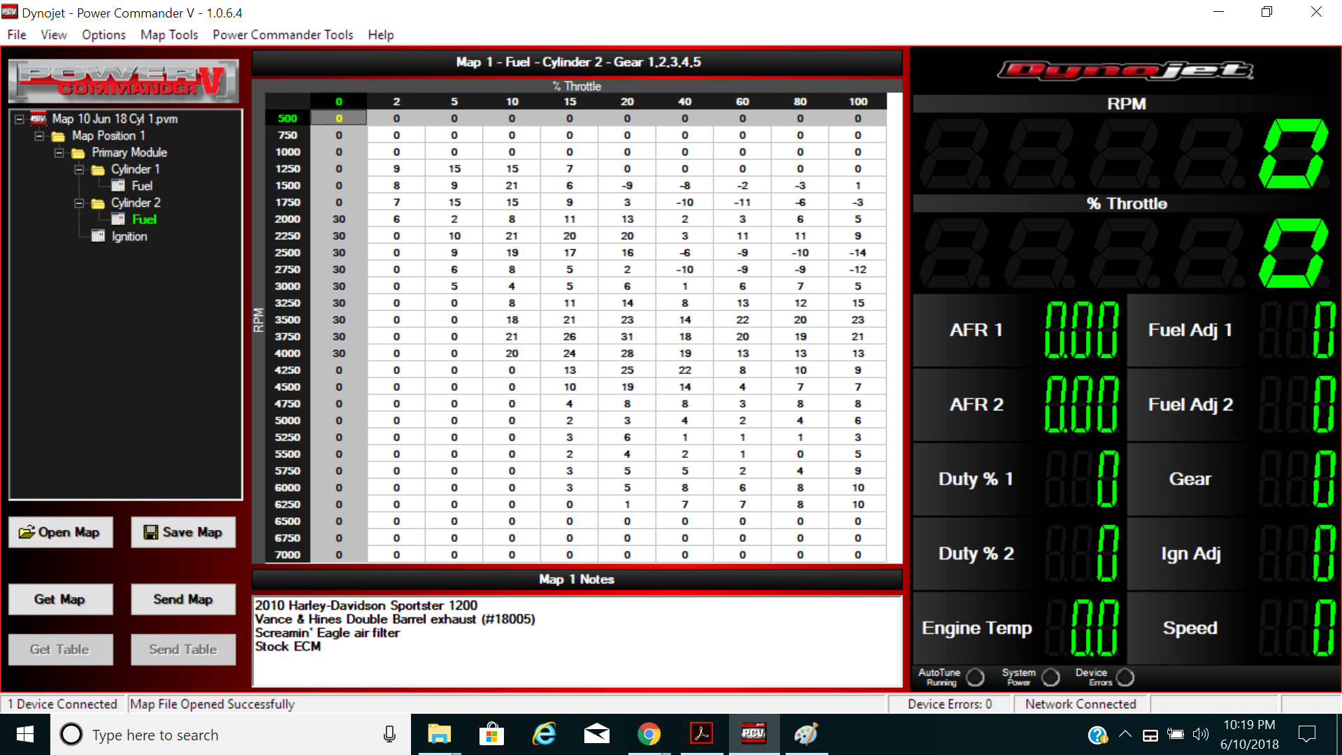

Current Table
Current Table
Will be sending these new table to see if the idle will come down

Originally Posted by ibrokeit
Current Table
Current Table
I have the PCV installed in my 13 sporty with k&n filter and
slip ons . Just looking at your map i would drop that row of 30
down to 5 or 10 if needed. Your dumping 30 % more at 0 throttle
causeing high idle.
