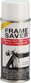

This is a problem on steel bicycle frames too (and much more serious as the tubing is very thin) so many people use this stuff...
