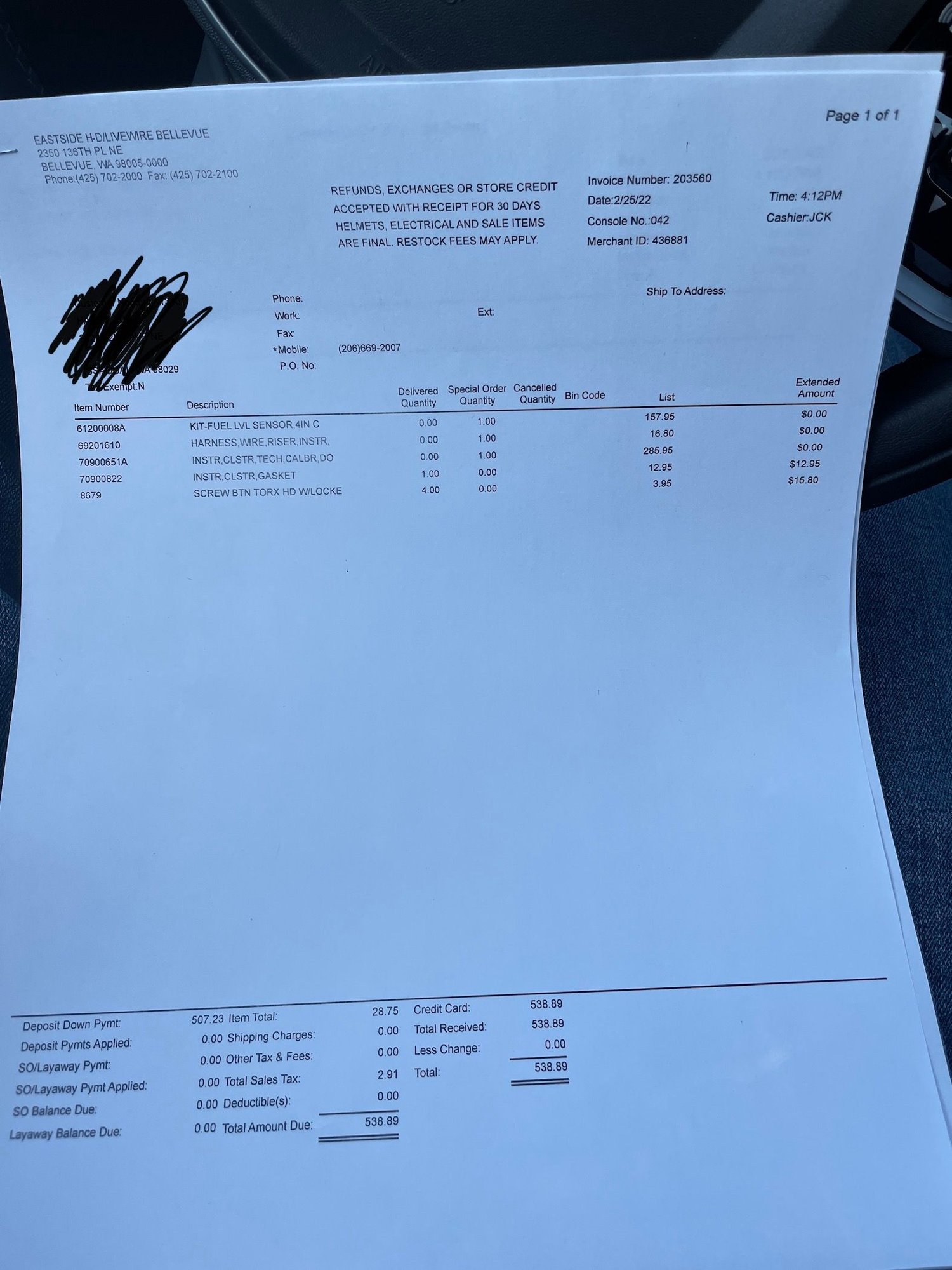

Probably I will be the first to try, the only problem is the gauge is in backorder and will only arrive in May.
