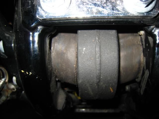

If you put the bike on a lift (or lay down in front of it) you can see the two front motor mounts. The photo below is from the viewpoint of having the bottom of the engine at eye level and looking straight at the front of the frame. If they are sagging it will be obvious.

so I took a look at it today. I tried tightening the big but it had but it doesn’t seem to want to get tighter, it just gets a little bit more tight then looses all the tension after a 1/2 turn.

You putting a wrench on both sides right.

IMO motor mount sag is obvious...you may also want to check your front engine mount stabilizer links.

Crazy, I just checked mine after reading this thread and mine are sagging too. I guess my bike is 14 years old, any idea how many miles/years you usually get out of the rubber mounts?

tried it again like that and what do you know haha it got tighter. Idk why I didn’t do that in the first place. Most of the excessive vibration is gone now, I feel like it’s still a little different then before hitting the pot hole but that might just be in my head.
