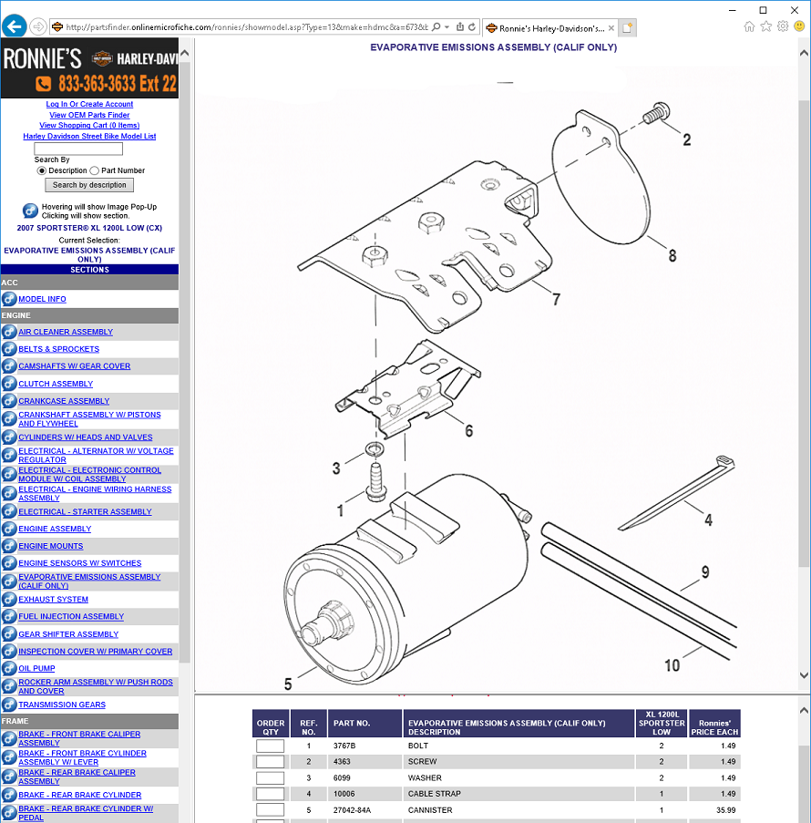

So am I. But it's not in the muffler. Look under your bike (CA model I assume) and you will see a black round cylinder...
My bad, that's a canister for controlling fuel evaporation:
So, IIRC our model year does NOT have cats.
