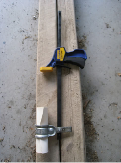

A homemade "improvised" tool from a furniture/wood clamp can be useful for this, here's some pics:
If the tube's threads are really butchered badly, I'd recommend getting a new/used tube
