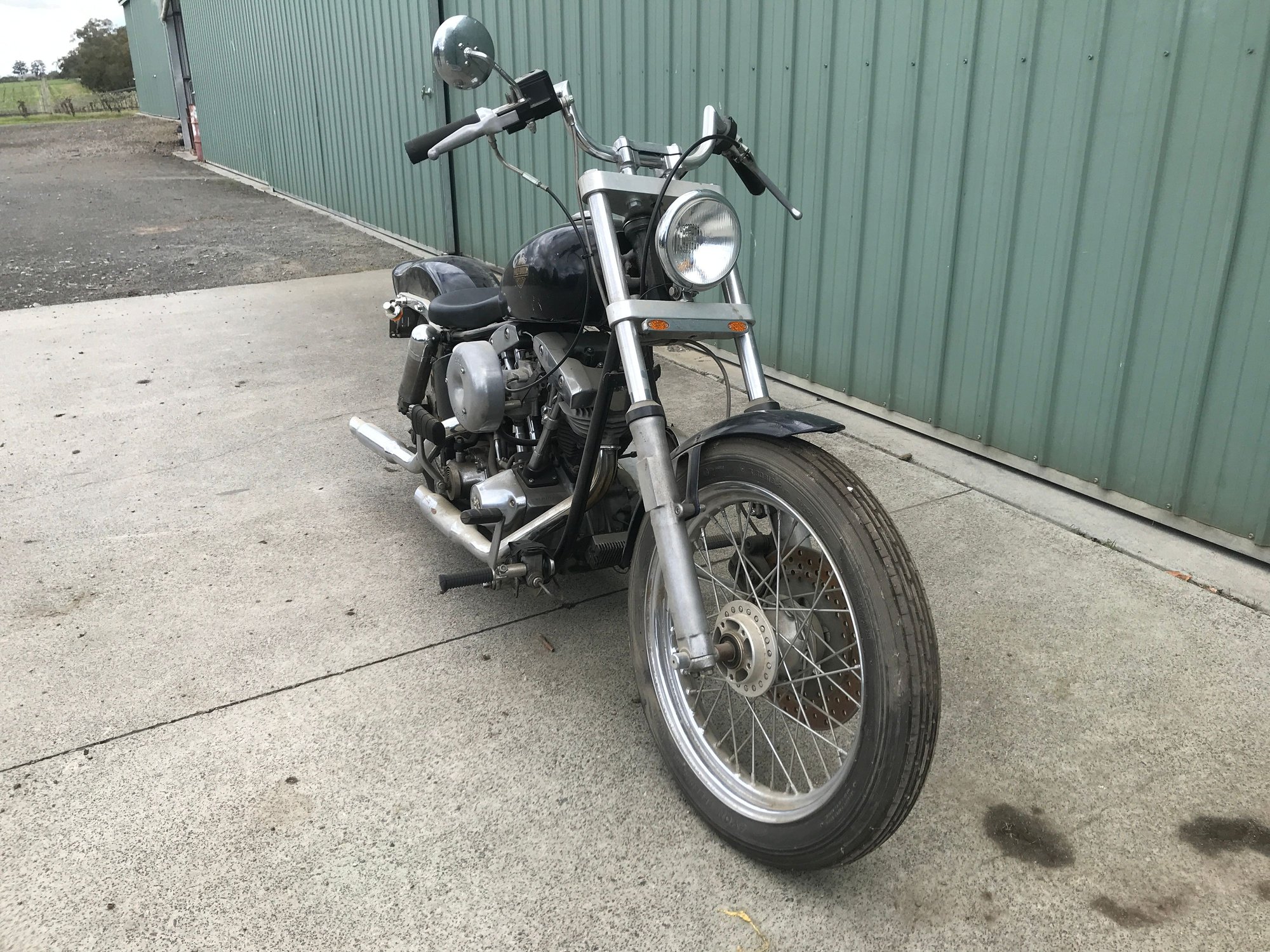

Hey HOGman, dud you ever end up having a go at this? I'm in almost exactly the same boat thinking of buying a Rocker C wheel on my shuvvy. Except my front end is of a 90s 39mm sporty front end.
Just curious to see if you ended up trying it. I'm pretty convinced that the hub is not gonna work, when you cant re-lace it to centre it it has to be narrow enough to get the disc in the right spot and still be centred.... pretty risky!

Looks tight hey.
Man, I'd just about given up on this and was about to buy a hub to re-lace the wheel I've got but you've breathed new life in to the dream!
Like you, the guy selling the wheel cant seem to understand what I mean when I ask him to measure the hub width, it's unreal.
I'm still not 100% sold though because I keep reading about how nothing is as it seems:
https://www.jockeyjournal.com/forum/...ad.php?t=65777
My forks are a little different to yours and I can see this ending up in buying a new front bake, but maybe that's for the best haha.
I was hoping to retain my old one but I guess maybe I'll just have to suck it and see. As one guy on here says it's our duty as HD owners to mix and match parts and make it work.
See below old ugly front end and wheel, and below that the beginnings of the new one.
