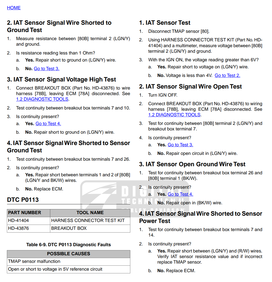

Recently, I'm getting this code "ECM PO113 Hist" on my 2012 Iron 883 the code comes on and off. My bike will still start right up and I drive my bike often with no problem even the code still there, sometimes I clear the code with my DynoJet. But just yesterday another code came out again ECM PO113 Hist with "IAT sensor voltage open High/EFI". Now, I need help to locate and how to fix it.Thanks!

IAT = Intake Air Temperature sensor.
check the connection..remove n replug again

Thank you HotRod917! Today I will try to check the connection and if I need to removed that sensor and try to clean up and see if the code will disappear permanently. How do I know if the sensor is bad? Is there any way to test, maybe with multi meter? any idea? before replacing it. Thanks in advance!

No problem so yes basically test for continuity and voltage read with a multimeter at TMAP and wiring harness to the ECU. Also check wiring harness for any cracks and shorts.
