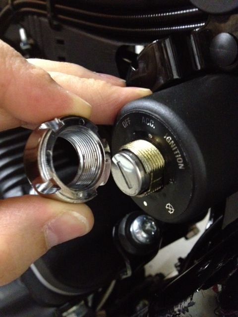

This is a picture from another thread. But kinda helps explain, the issue I’m having is the nut will go on the actual switch but it slides down almost flush with the black housing before it actually threads on to anything. Then it only threads 3/4 of a turn at most. It looks like it should catch threads as soon as you slide the nut over the switch but mine doesn’t. Nothing appears to be messed up or anything.

Have you tried turning the nut over and screwing it on, sounds like the thread may be tapered?
you could always wrap some plumbers PTFE tape round it.
did the nut come with the switch before it was re located, or is it part of a kit with the mount?
if part of a kit, send it back. If the threads are not damaged, they must be a miss- match of sizes.

I bought the bike as is. But the nut looks exactly like the one pictured. The one pictured is from a stock bike in the stock location. All the relocation does is move the existing switch to a new location. It doesn’t change the housing or anything.
