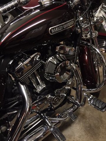

Kuryakyn velocraptor AC is fine for stage 1. You will get more velocity with a longer stack. I also used an Alren Ness and there was no noticeable difference in power gains....same with the Outlaw 587.
Did not have to change the tune on my Powervision which means the air flow was comparable. I ended up with the Arlen Ness since I liked the quality and look better, and used a custom discrete external breather system from DK.
