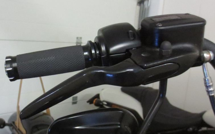

You can just simple cut the ones you have nothing to it, the result is the same thing and you saved $109.99 .
I did about the same with the levers of my FXBB, not shorter because I wanted the blade look so I just cut of the **** and filed a bit,
sanded the whole thing and powder coated them black.
