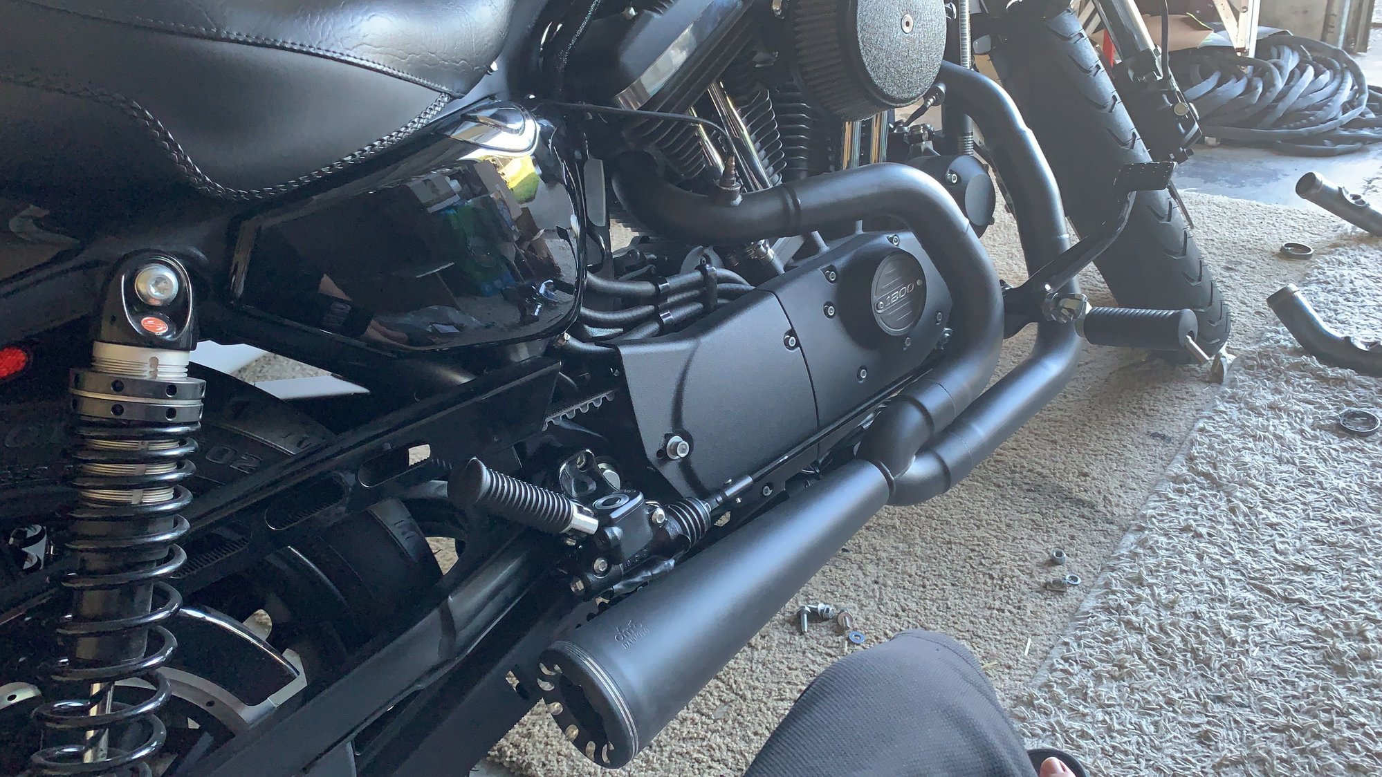

Thank you everyone,
that actually helped a lot, some parts were tougher than others but I finally did it

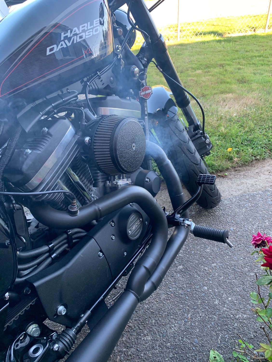

Also is this normal or did I mess up lol

I would have to say on a quick examination to have the O2 sensor outside like that doesn't look right.
The front one pointing toward the back and not to the left side of the bike also doesn't look right.
A faff I know but you might want to try swapping the headers around. Did you get instructions?
