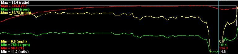

This is a graph of my Sportster stopping for about 60 to 90 seconds at a stoplight.
Data is from a log file from my PowerVision.
You can see the temp was about 360-370 F while running, and cools down to 334 F at the blue mark, (red is engine temp(rear head) 334F, yellow is speed 0 and the green RPM is 1014 Idle speed, 14.6 is the set AFR (closed loop) ).

Now I want a newer fuel injected Sportster so I can log the temperature on my commute.
And I would love to see someone with a ton of money take a Sportster on a hot day with some thermal cameras monitoring it, maybe some temperature probes and just let it sit and idle till it dies. I'm sure the MoCo does that sort of testing occasionally but they don't share the information.
