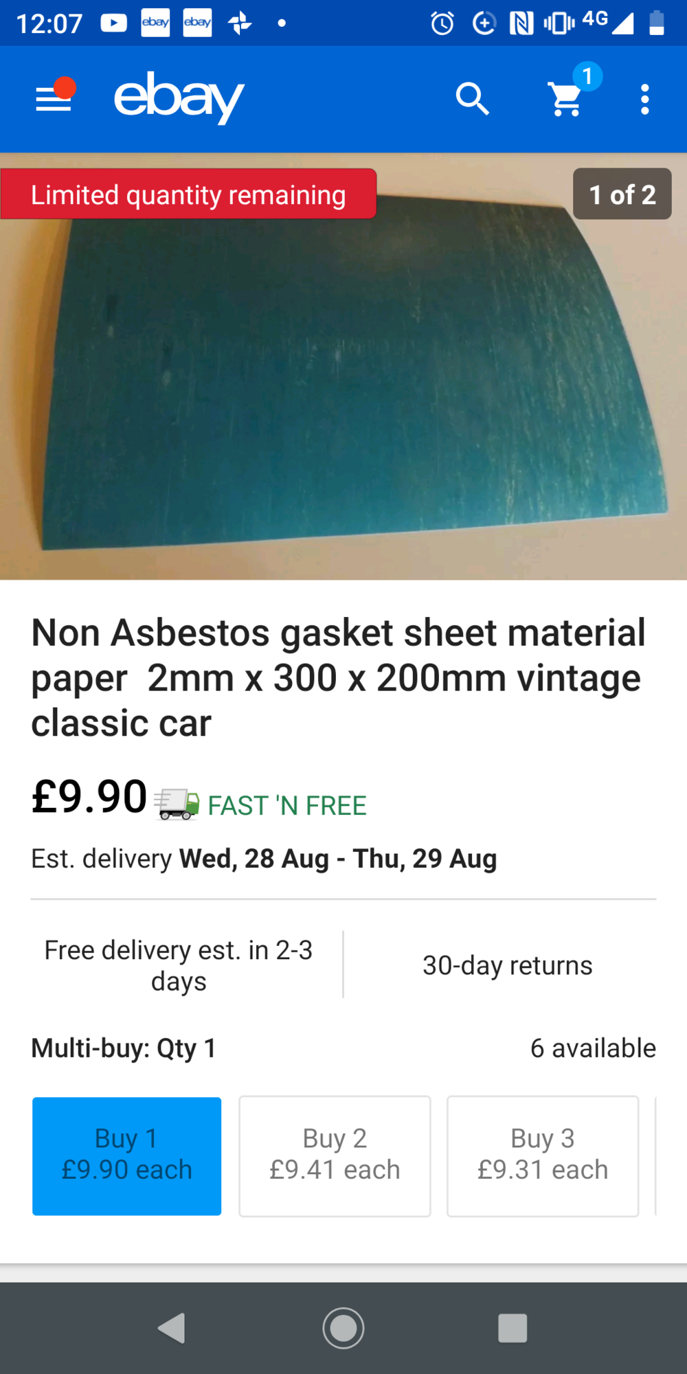

I'm going to order some of this stuff and stick strips if it behind all the jubilee clips . Got to be worth a shot . I'm still keen to hear of anyone's alternative solutions .

This is 2mm and I could always use it double .

They have been alright today since I put some very thick gasket paper under the rear heat shields . The trick is to stop them touching the front heat shields . It won't last because it will burn but if I replace it with something more durable ( see previous ) it should do the trick .
