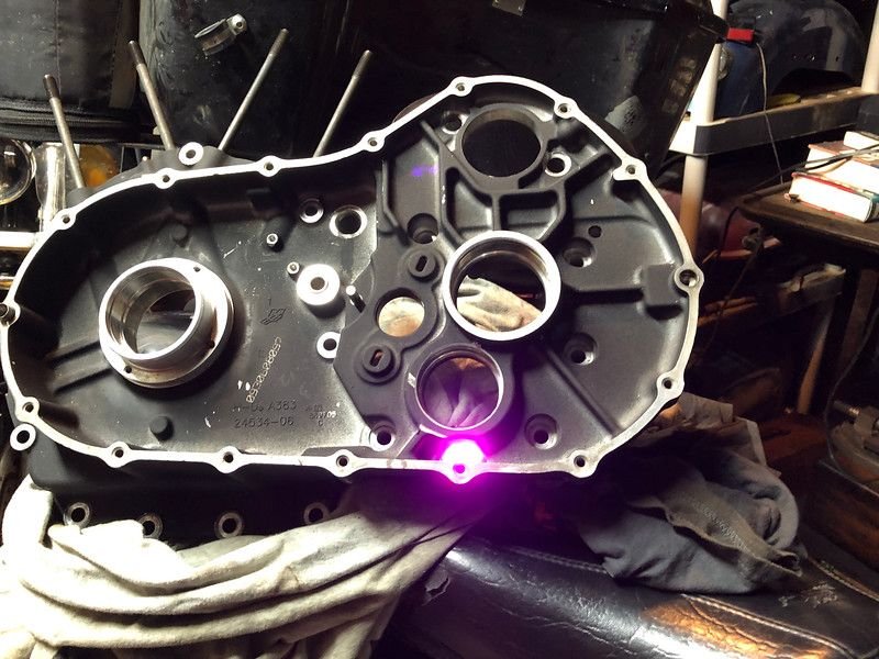

Originally Posted by cacomly
LOL, I should have read the rest of the thread to see how many people responded before I did. Didn't mean to jump on a dead horse
I revised my post as you were replying and will try to remember to take photos of my cases tonight as they are sitting in a box under my workbench waiting for me to rebuild the engine
Ok, as promised here are the photos of an engine case
Outside of the left half of the case where the primary sits. I put a red light behind the case to show the opening where the primary and transmission share fluid
The inside of the same half. The back half is where the transmission goes and the front is where the crank assembly is. Note the divider between the two. Also, you can see the other side of the opening between the transmission and primary at the bottom under the hole for the secondary shaft
And to put the primary side into perspective, here is a photo with the primary chain and sprockets removed
Old Sep 26, 2019 | 09:43 PM
  #97
Longplay's Avatar
Longplay
Posts: 270
Likes: 64
From: Camotes Islands, Cebu, Philippines
cacomly
Just as clear as daylight!! Many thanks for the effort!! I am clear now and can put this into the old internal hard drive of my head....
Good news in my mind, as it keeps the clutch wear debris out of the engine system. I know the filter is supposed to protect things, but those tiny filters are likely only 25 to 40 micron style elements, and it is the 25 size that do the bulk of damage internal to the friction parts. Good to know, they are segregated to the transmission.

Interesting how there's a small protrusion of case metal in the oil passageway. I wonder if it's to prevent debris from getting in (or out) of the gearbox. It looks deliberately designed like that. Or, perhaps to keep oil from going from side to side rapidly and causing oil loss to the gears? What's it called, windage tray? Oil Baffle? I forget.
John

I told this much earlier in this thread that the primary oil is shared with the trans but you guys need a photo to believe it
Old Sep 27, 2019 | 09:31 AM
  #100
Longplay's Avatar
Longplay
Posts: 270
Likes: 64
Yeah, and with good reason....... Conflicts from even HD mechanics...... don't believe everything you read on the internet!!
