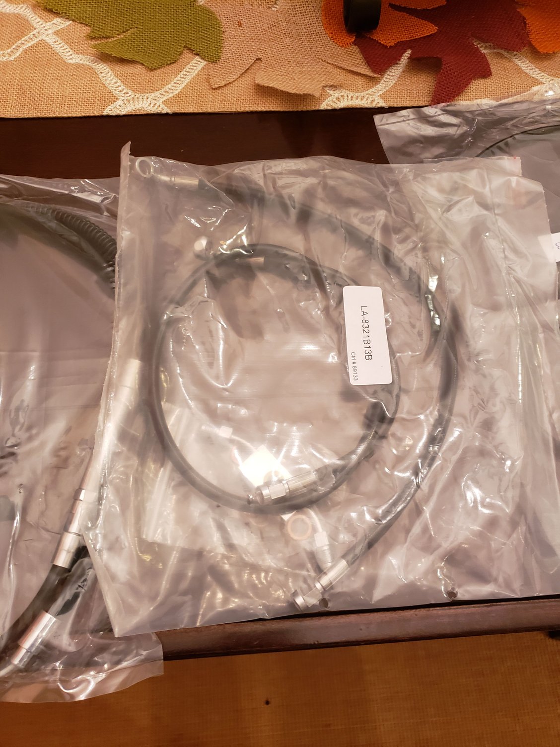

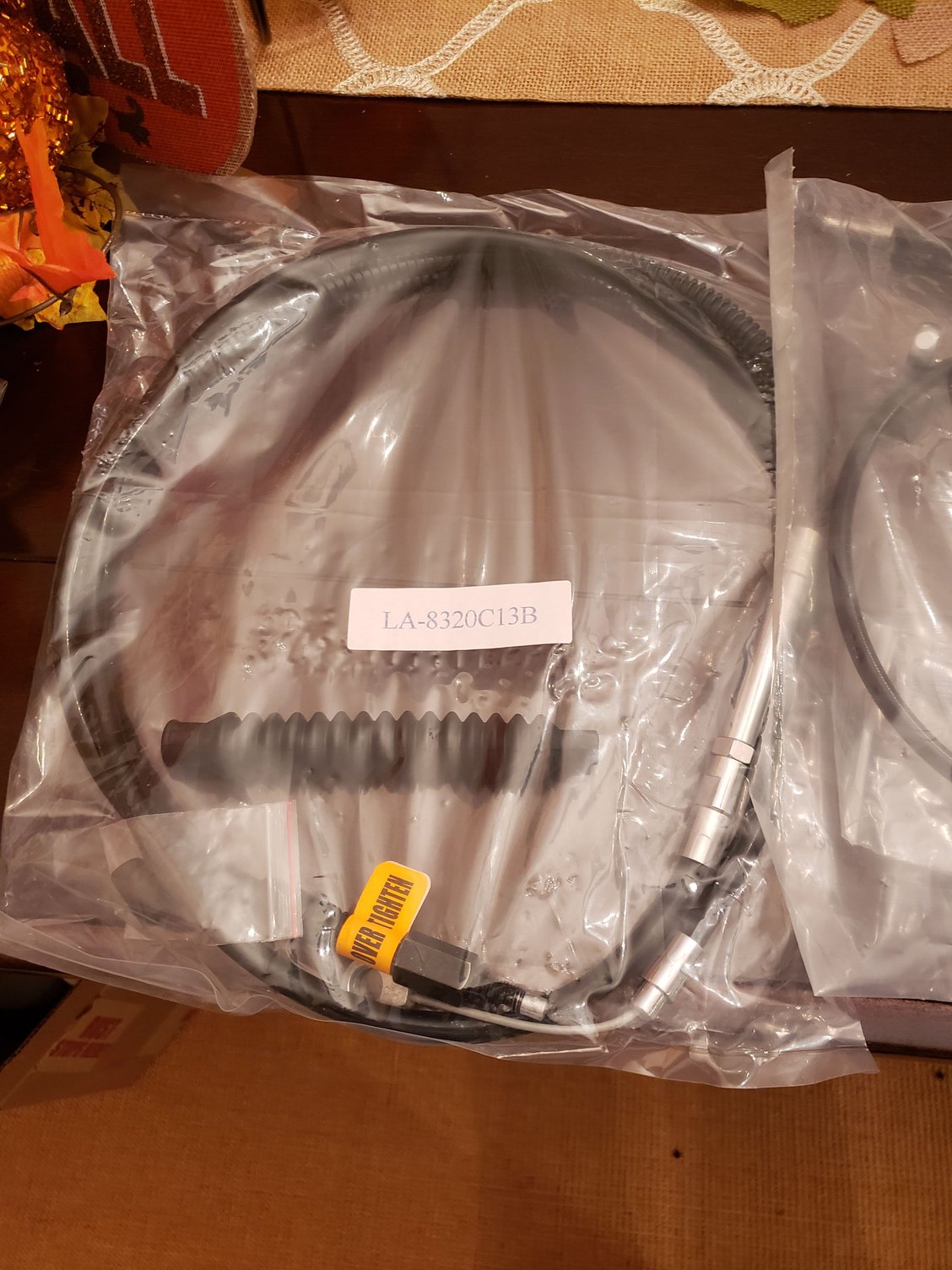

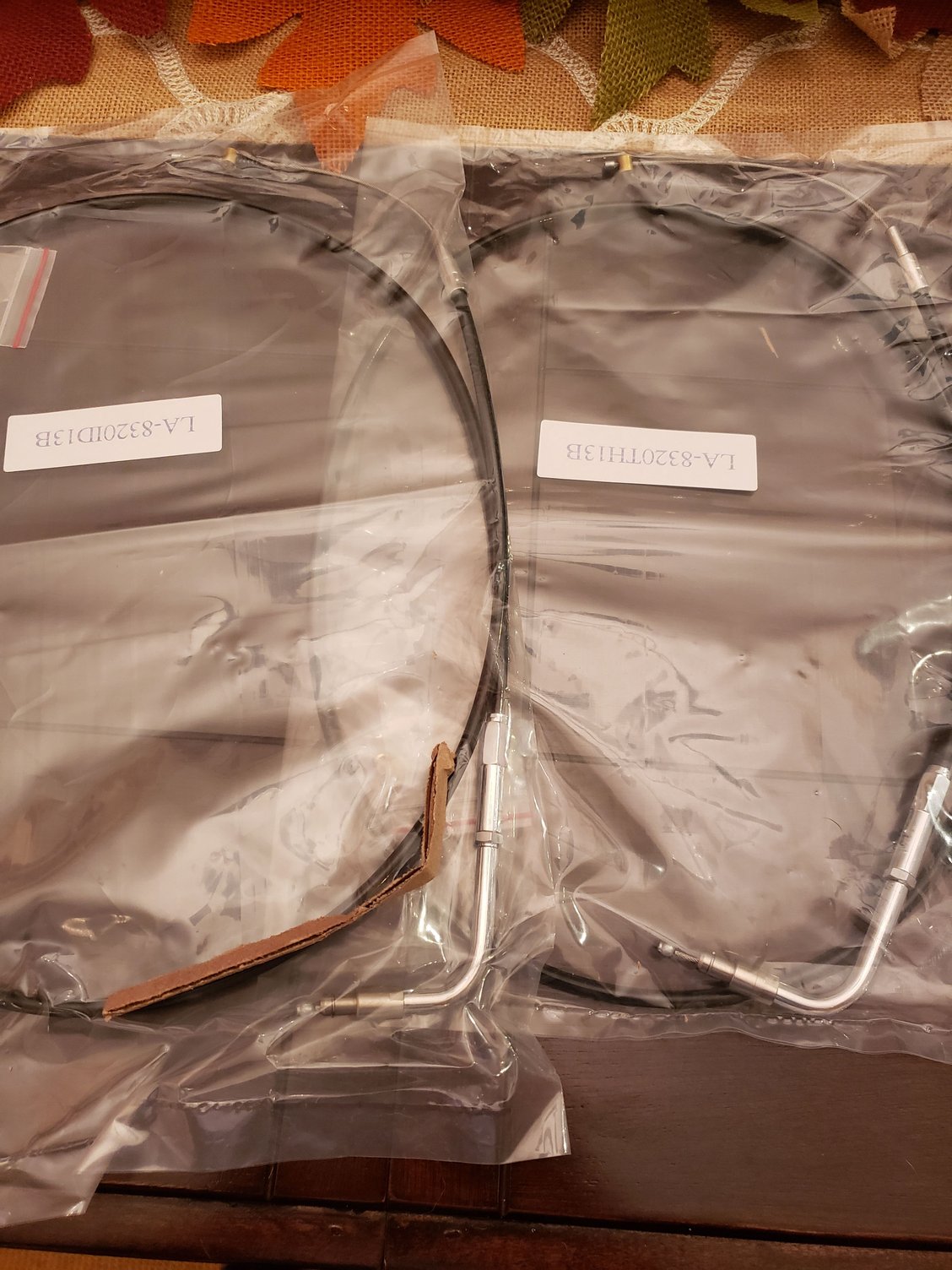

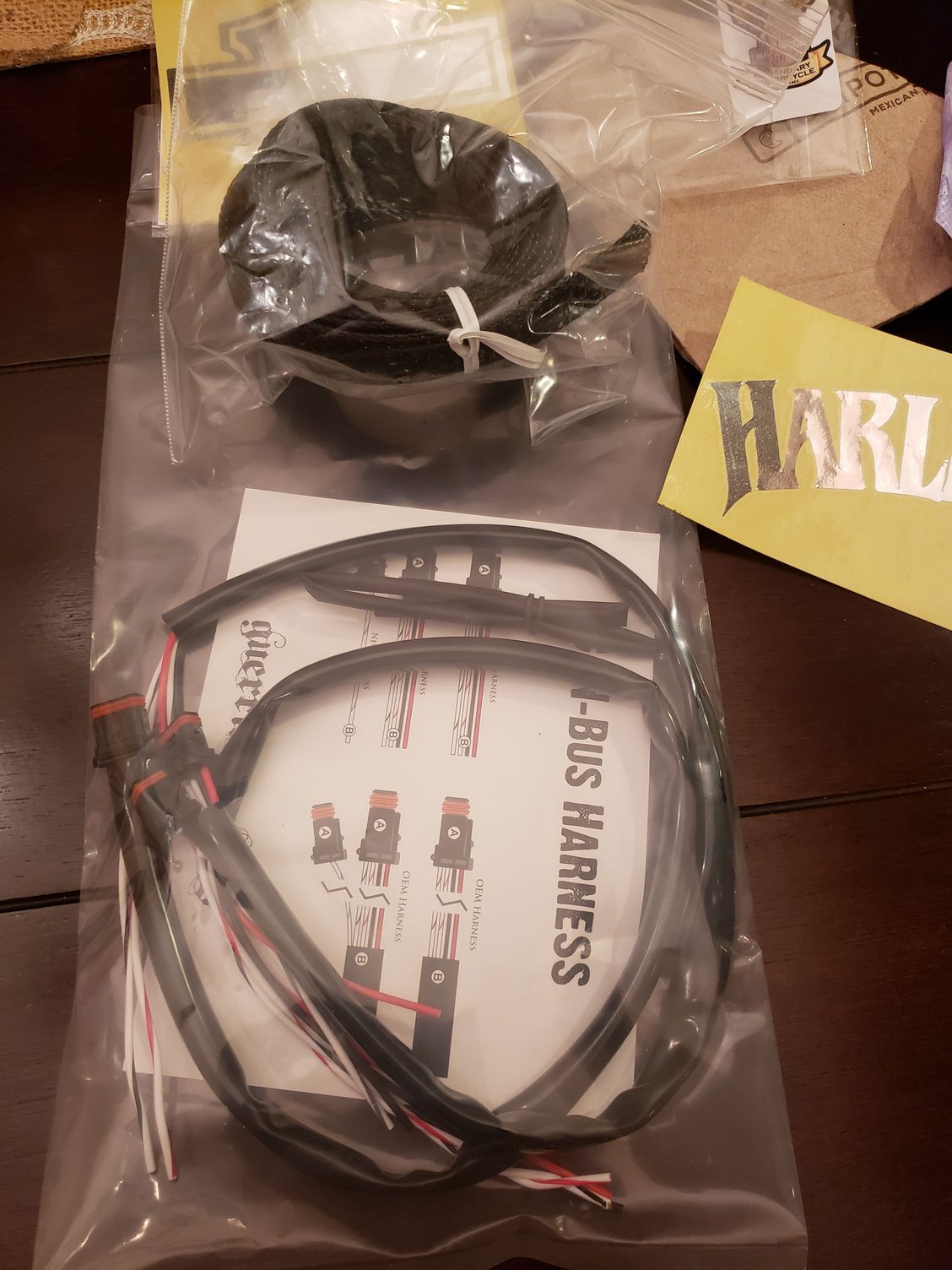

Can you post pictures of the wiring extensions you have?
basically you have two options with how the kit works.
1. Wires have some kind of connector already attached on both ends -- no solder required.
2. Wires have a connector on one end, and the other end is just plain wire -- requires soldering.
I've seen more of option 2 when shopping, personally. But he's right that if they have connectors on both ends, boom you got the easy kit.
