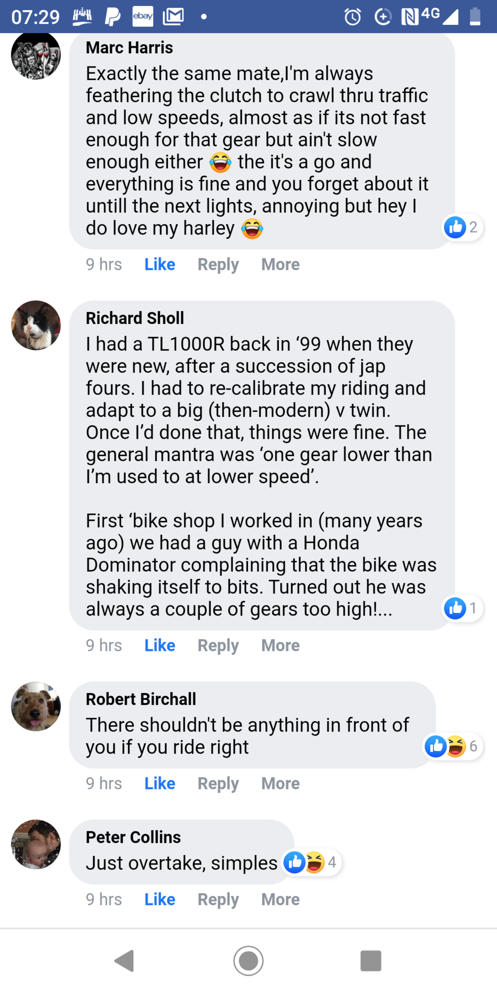

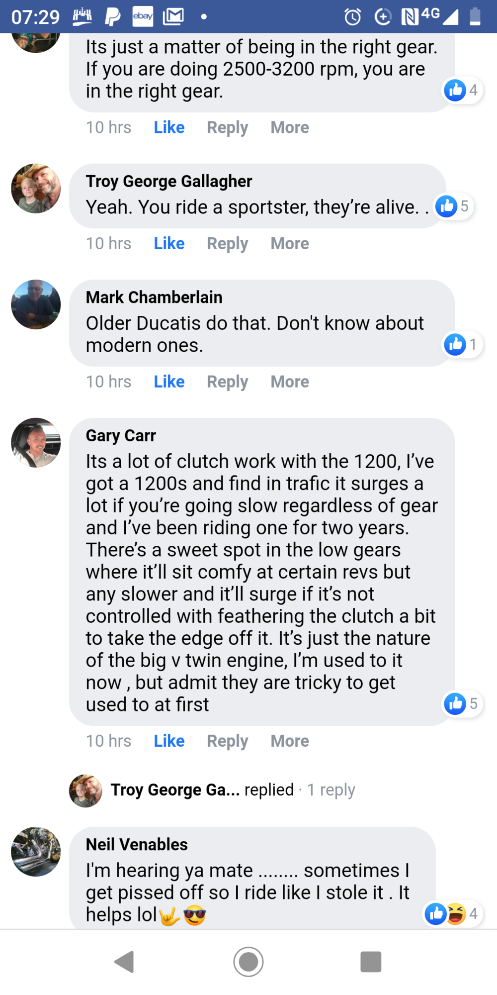

Here you go , I think I posted the same page twice .

Yup you did. I thought it was me at first LOL. I see no reason to NOT use the clutch (in the friction zone), but it should be used with the rear brake too. You'd be surprised at how well they can be handled at low speeds that way.
