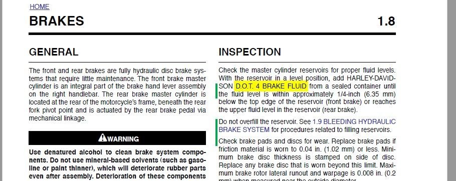

What manual do you have? ... 07 uses Dot4 (first year)
DOT5 is silicon based NOT DOT5.1 (it's like DOT3/4)

Mine is the HD 2007 Sportster models service manual

They changed to DOT4 regardless if the bike was equipped with ABS or not
2007 Sportster FSM
All model Listing for Dot 4 in the HD P&A Catalog (good reference for all model lines)
