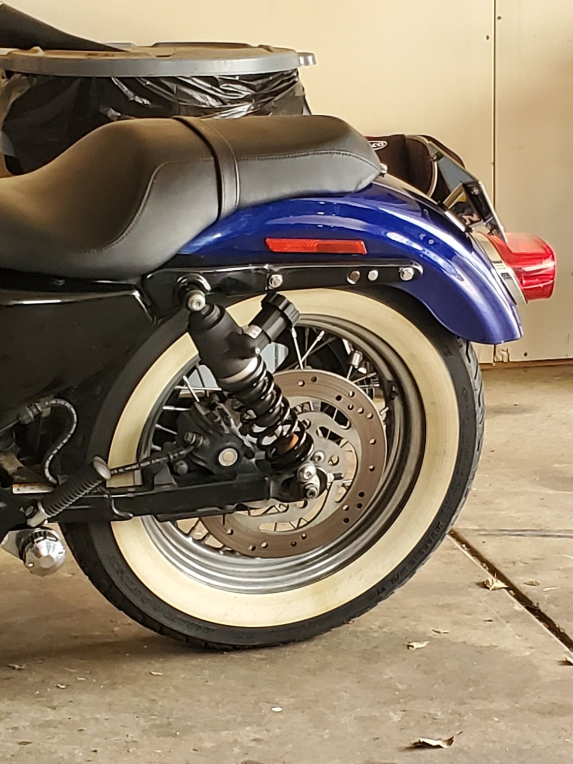

The Ohlins 916E are great though pricey, work well on my bike for solo or two up. For the forks I went with the HD SE fully adjustable cartridge kit and it works really well too (so did Shanneba IIRC). Total cost for both was about $1100 but well worth it for the greatly improved ride AND my bike now rides slightly higher than even stock Roadster height...
