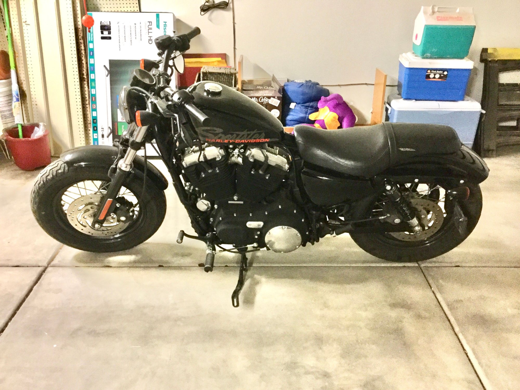

Hey there. I got a new-to-me 2011 HD Sportster XL1200X 48. Just over 5,000 miles. And I paid $4900.
I’ve got the basic upgrades planned: handlebars; stage 1 air, exhaust, fuel pack. IN a bit.
I have a couple questions:
1. If I’m putting together an HD toolbox to keep in the garage, what tools do I need? I know monkey wrenches, socket set. I know torque wrench but what drive size? I know torx bit set, but do I need them in bit form so they fit into a socket, or do they make them like sockets? What else? If you answer, see the service manual, that’s fine. I looked in the Haynes manual and a the list was LOOOONGGGG!!!
2. My first upgrade will be handlebars. I want 8” riser chumps. Will I need a new brake line, clutch, and idle and electrical? Like a Burley wire kit? If so, why are the wire kits nearly $300 while the bars are around $100? Is that just how it goes and I need to budget $400 for bars?

Your bike is gorgeous, love the orange and black! You got a great bike at a killer price IMO. 5000 miles, what a bargain, she's practically brand new.
