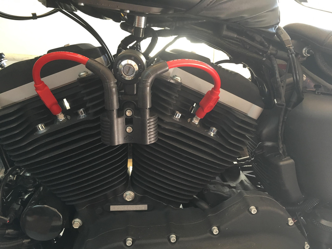

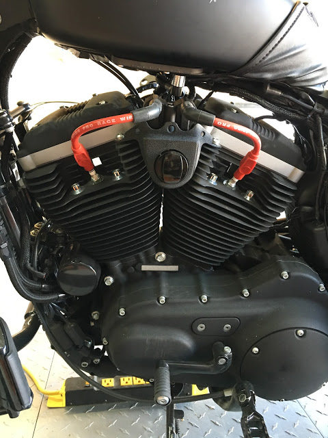

No you do not "need" to do a tank lift with a wire tuck. Granted, you can not locate all of the
wiring connectors on top of the backbone, you have to position them on the sides of it.
Here's a pic of mine - no tank lift cause I personally don't like them, but to each their own....
And here's an older pic with the type of coil relocation that most folks perform.
good luck,
T.
