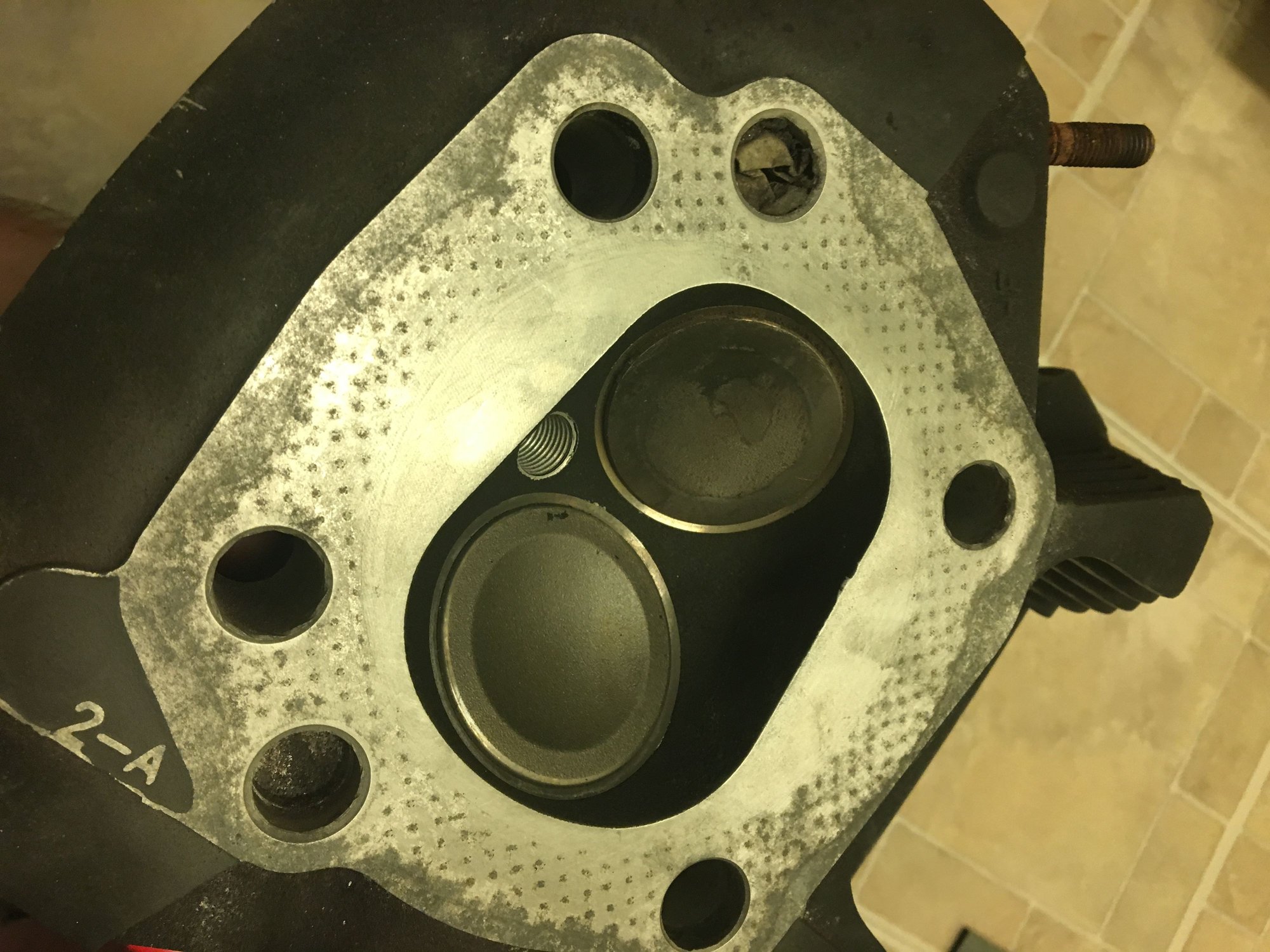

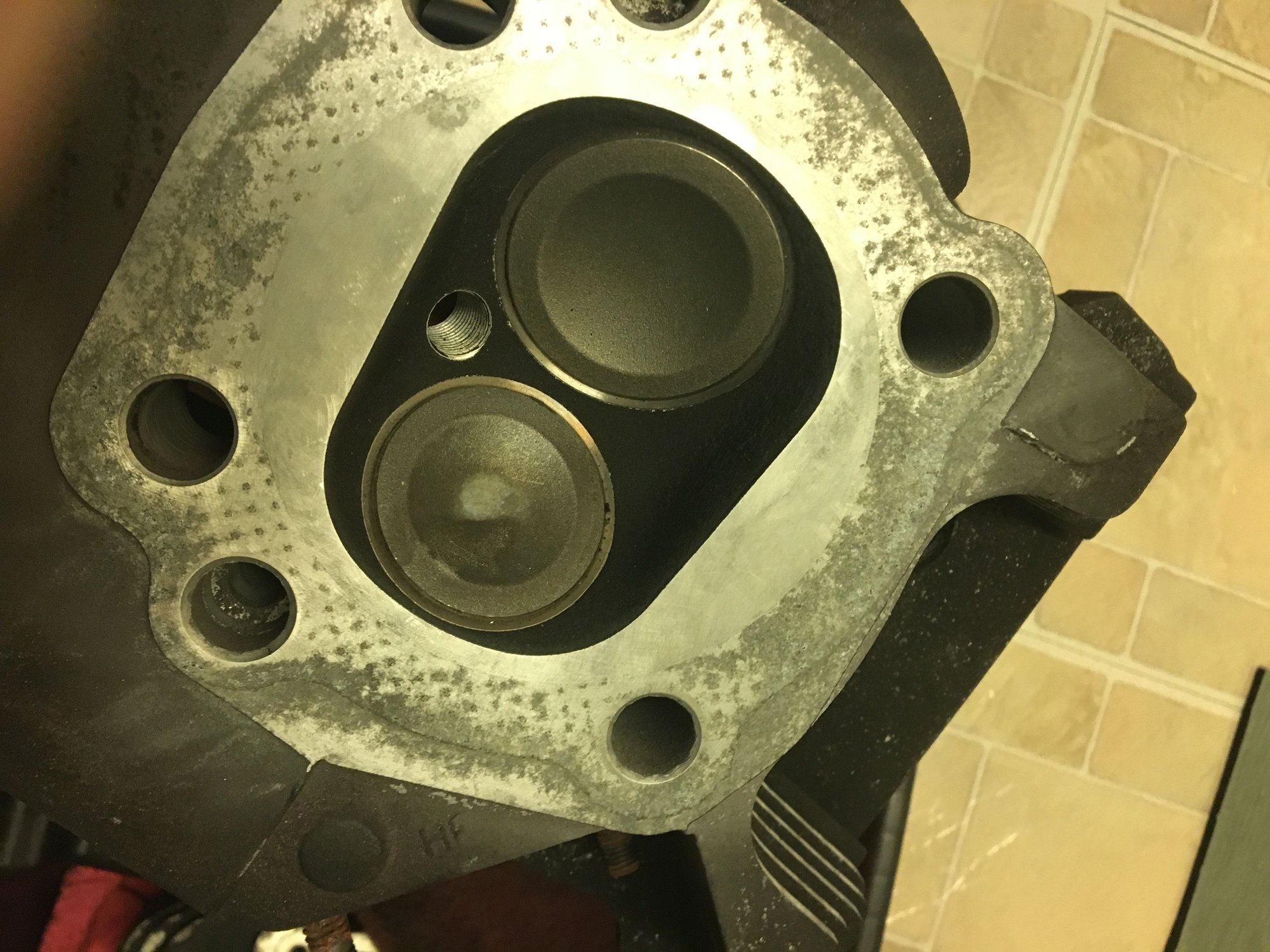

So I’ve got a pair of used 1200 heads going this weekend hopefully and I’ve gotten them pretty clean they just look like crap.
ive cleaned all the gasket off with gum cutter and a razor, smooth to the touch... like if you were blind folded you would think it’s just been machined. But the aluminum is stained. Also the old gasket put very tiny little pits in it.
Has as anyone ever had a gasket blow?
What are your methods for cleaning surfaces? and I’m not keen on scotchbrite.
do I need absolutely need them decked?
there are no high spots I can feel or see with a straight edge. I would assume the most important place is the small area between the bolt holes and where the cylinder wall starts.
ha don’t bash me for trying to cut corners or anything.
also going with a cosmetic gasket.

If you can't catch a fingernail while dragging it over the flats your good.

They look almost ready.
If they were mine, I'd lightly run my flat stone over the deck to make sure they are free of any high spots.
Use a little piece of sand paper and just soften the sharp edge around the chamber a little more.
Deburr the spark plug hole. Those burrs are a big no-no.
Remove the exhaust studs.
The chamber looks funny. It looks like you did a valve job but somehow left the carbon intact? Not sure what I'm seeing there.
