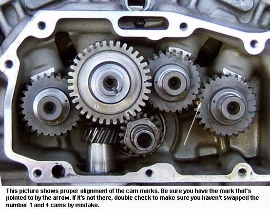

My brother recently purchased a 1987 sporty 883 that had the chain jam around the front sprocket. Previous owner said check the trans to make sure gears were ok and other than that the bike has no issues. In his infinite wisdom little brother removed the cam cover and before you know it he calls me to put new pushrods in and put it all back together. I put adjustable rods in and reinstalled everything to the letter by the service manual. It will not start. Plugs fire, it's getting gas, and rods are not jamming up and everything else seems normal. Timing marks at the same position. Could I have put the cam gears in on the wrong stroke? I lined all the marks up and read that the coil fires both cylinders every stroke so I didn't think about it being compression stroke or exhaust stroke I just put it TDC and figured that would work. Thanks for the help and feel free to belittle my intelligence. I've been married 17 y ears im used to it.

The correct position of the motor to install the cams is with the crankshaft pinion gear in the correct position to line up with the number 2 cam timing mark.
There is a timing mark on one tooth of the pinion gear.

It is possible to get the ignition timing 180 degrees off. All the marks line up but the front cylinder is on the exhaust stroke instead of the compression stroke, and it will make a big difference. I learned from experience. The cam timing is pretty straightforward thanks to the marks as shown ^^^.
