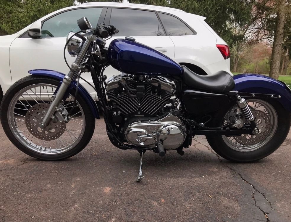

I’ll show you what I did. Mine is an ‘06 Custom so it originally had that super fugly chrome pullback riser/speedo combo. I ditched it many years ago for some short stock risers and speedo mount off another Sportster. I slightly enlarged the speedo mount bolt holes so that I could mount the clamp right on top of the triple trees. Not sure exactly what would be entailed to do this on your 2017 but a potential option for you.
