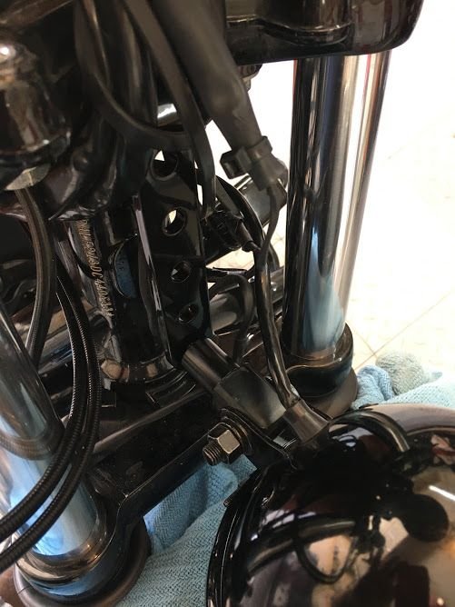

Originally Posted by WKNDS
This is the only other pic I have that shows the spacer I used between
the headlight clamp & rigid mount....
hth,
T.
Thank you very much, does the the headlight sit tight to the forks - I've seen some mounts tgat push the light right out
Old Feb 2, 2021 | 04:12 AM
  #42
WKNDS's Avatar
WKNDS
Joined: Nov 2012
Posts: 4,988
Likes: 2,078
From: Newport,TN area
I guess that will depend on what kind of headlight bucket (is it large or small depth, 8" or 5-3/4") you use
and the mount that comes on it.
good luck,
T.
Old Feb 2, 2021 | 04:41 AM
  #43
Elzer0's Avatar
Elzer0
Joined: Dec 2019
Posts: 84
Likes: 22
From: Rochester, kent, uk
good luck,
T.
Will be the standard 5 3/4 size, Bates style

Drag specialities headlight mount on order (same as WKNDS).
​​​​​Got a speedo mount floating about.
Making oem idiot lights water tight started.
Need to order a Bates style headlight next and look at how to swap wiring over to new headlight
