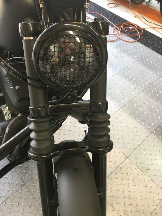

Originally Posted by d10221
is that an extra bracket before the risers ?
Yes, in my post of this picture I did say " stock risers on top of ~1" riser extentions"
T.

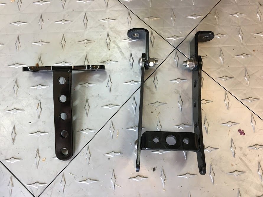

now I want to get rid of the eyebrow
....snip...
I have used several different versions. The one with "infinate adjustibility" actually
became a headache to "adjust" because there were so many moving parts. I
wound up using the simple rigid mount on the left;
good luck & hope this helps,
T.

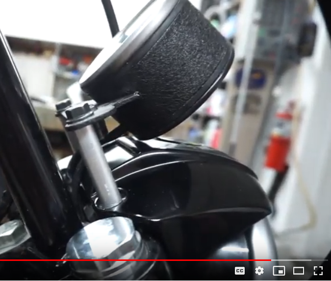

https://www.youtube.com/watch?v=tACW...ature=youtu.be
A bit too tall, but maybe with shorter , or no spacers or bottom mounted headlight

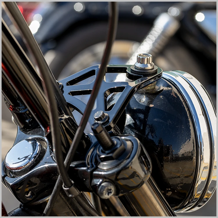

Auto meter clamp
source: https://www.hdforums.com/forum/motor...ll-see-nj.html
