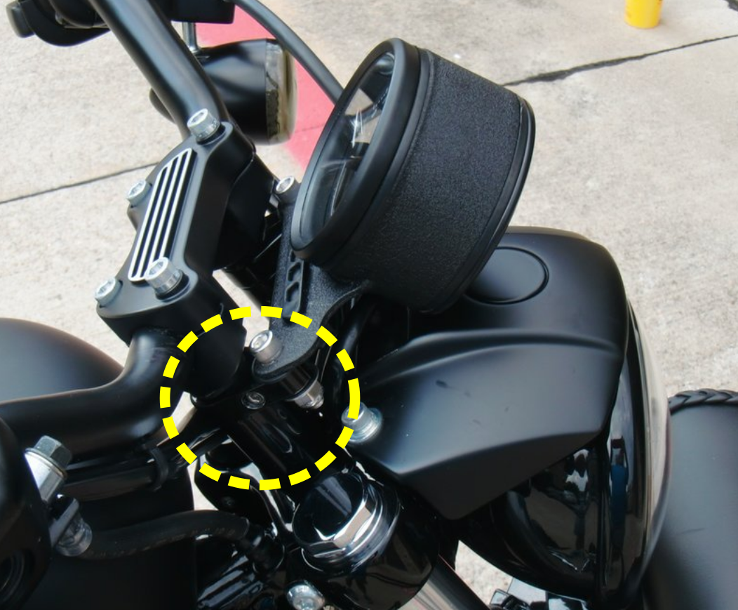

Found a pic from where I used the billet clamps on the stock risers on top of ~1" riser extentions,
old style handlebar clamp and still using the eyebrow mount for the headlight....

is that an extra bracket before the risers ?
