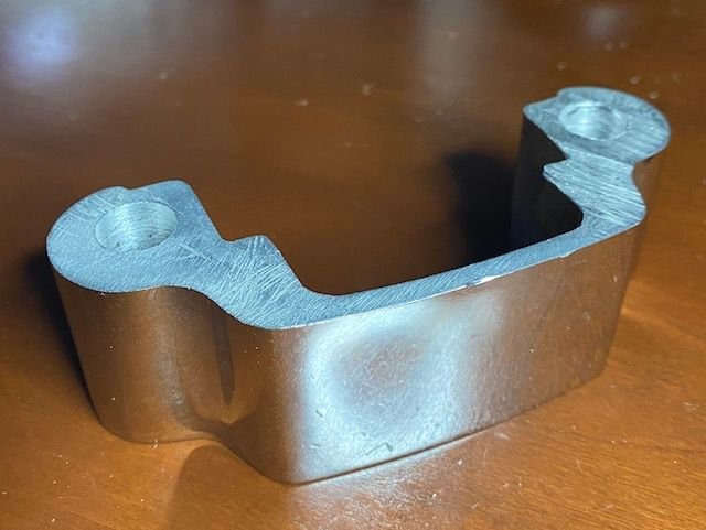

I like the stock riser but wanted to raise it up about 1 - 1 1/2 inches. Looked around and could not find anything that would work so, took an old riser like mine that I got for $20 and cut the bottom off. Drilled out the tapped holes, polished it up and now have a custom spacer that will look stock. I needed the extra height for a better riding postion and I'm raising the front of the tank and inch. Still need to do some sanding on the cut end but, hard job is done.

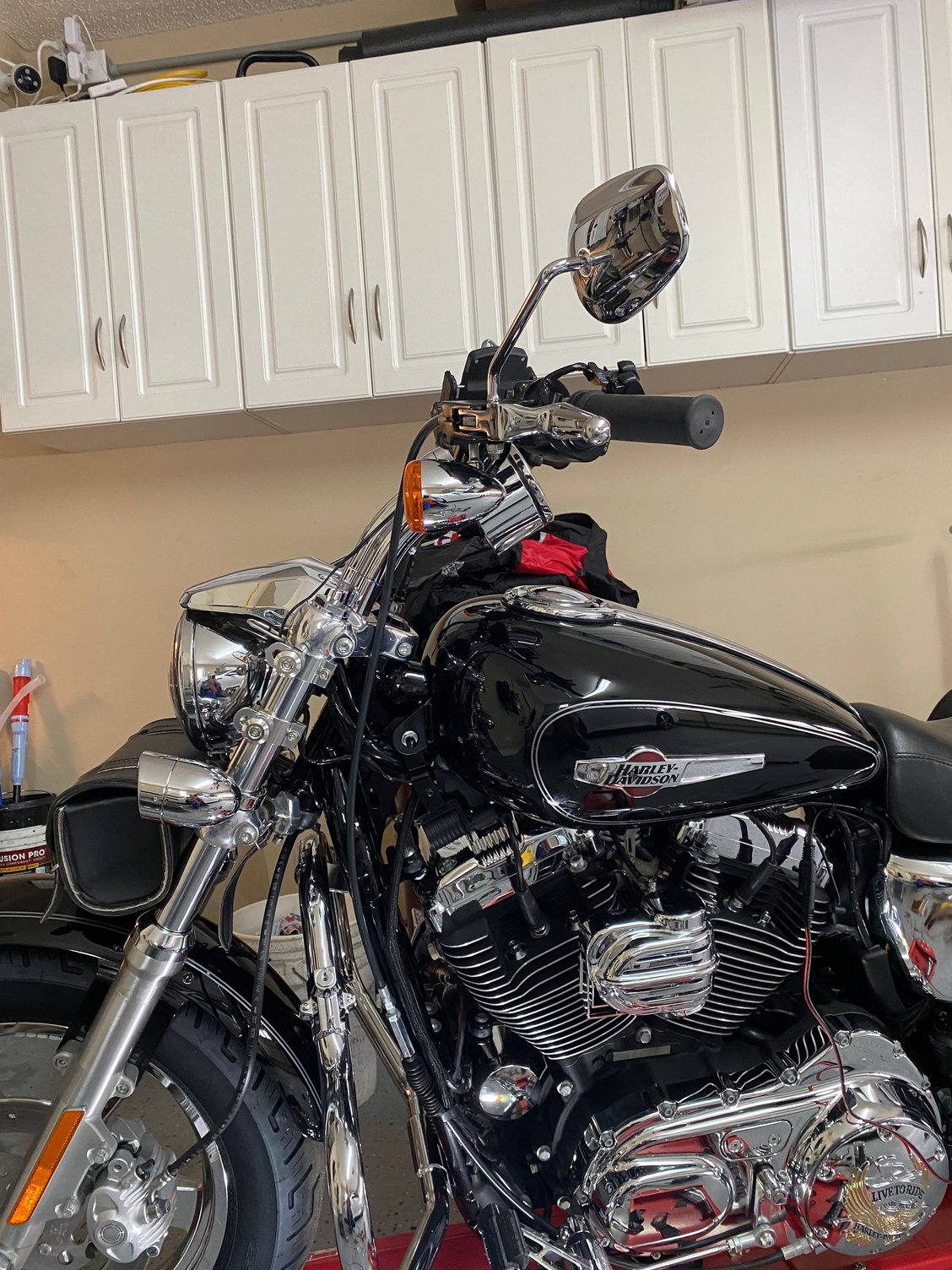

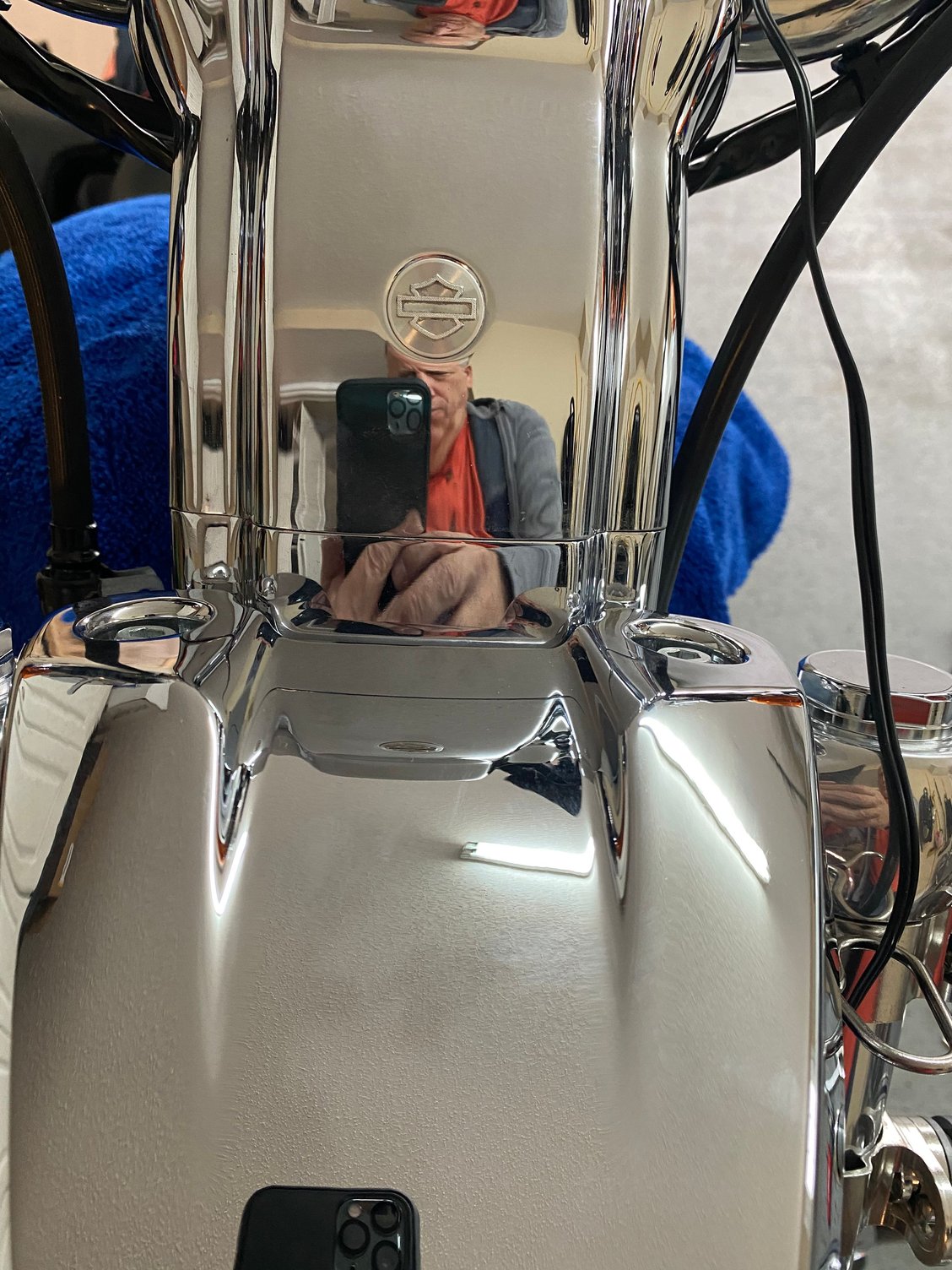

here ya go, did not need longer cables.
it brings the handles up about 1 1/2 in high and about 1/2 back

Nice work! Practically invisible.
