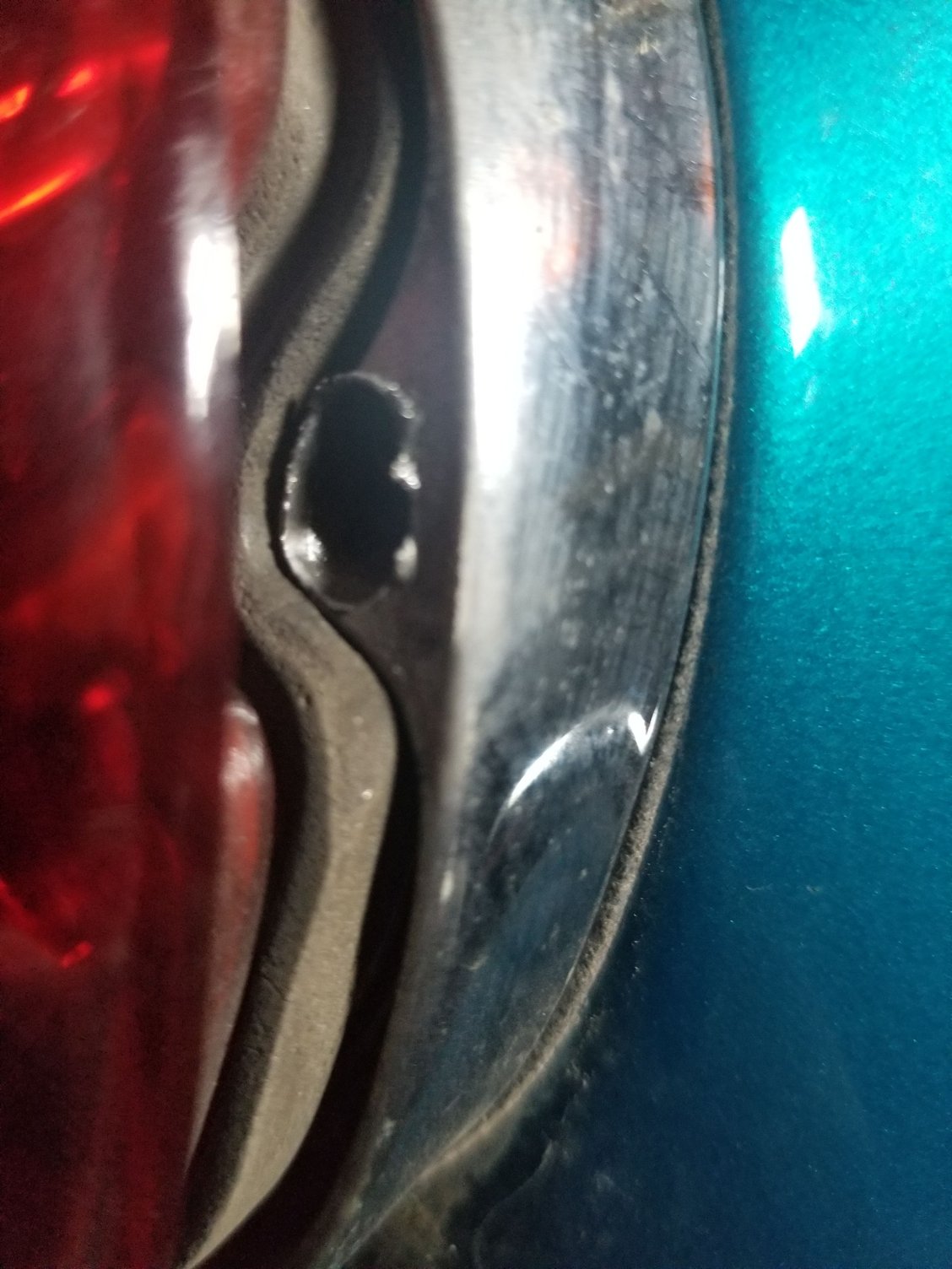

I had a flashy chrome cover over my taillight and it's gone after yesterday's ride. It was attached by the same screws as the taillight. One screw is missing and the screw hole is wallowed out so I can't simply replace the screw. Problem is the taillight is loose and I really don't wanna lose that. Any ideas or suggestions on how to fasten it? Homemade brackets maybe?

How about replacing the worn parts with new or try using a big ugly self tapping sheet metal screw? If you go with big and ugly try not to crack the plastic.

That's the problem, the taillight won't accept a screw large enough to fit the hole

Not sure what yr bike you have, you can purchase tail like assembly's pretty cheap
https://www.jpcycles.com/product/340...hoCgcMQAvD_BwE

From the under side of the fender hold a washer then use a rivit catching the washer.
only issuer doing it this way is if the bulb needs changing the rivit will need to be drilled out
But it is a 2 min fix

awesome idea! Thank you!

What if you need to fix it while on the road? Just a thought.

rivits are soft wire cutters will snip right though

if I lost it on the road I imagine the lens would shatter and there'd be no fix. Trying to avoid that situation though.

That should work. OP if you want to ride now try some duct tape (try to keep it off the paint) until you get the part.
