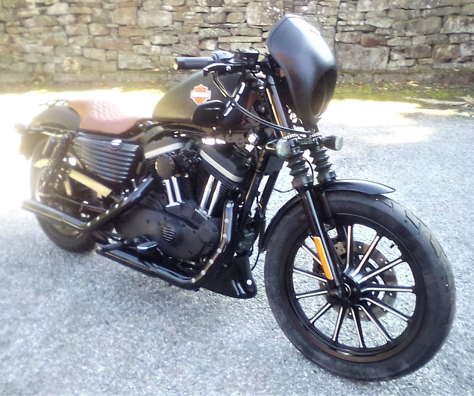

I've installed Roland Sand's Design knockoff velocity stack on my 2011 XL883N. I bought it on the Aliexpress website for only £14.20 including shipping to the UK. Its machined from aluminium and anodised black with a stainless steel mesh grill. It didn't come with any filtration, so I bought a 3" diameter stainless perforated disc, I then added three layers of air conditioner filter membrane and I swapped the stock stainless wire mesh with a 3" black speaker grill and I swapped all the shiny hardware for black stainless steel equivalents.
I have Python 2.5" slip-on mufflers and Nightrider XiED enrichment leads to control the fuel / air mixture. I think the stack looks neat, and it certainly does the job, you can see the result below.

nicely done , looks good , nice looking bike over all aswell 👍

Thank you for your kind words, I've gradually customised my Iron over the years since I bought it in 2011, I think I've now got it how I want to look.

I really dig the Outlaw fairing.

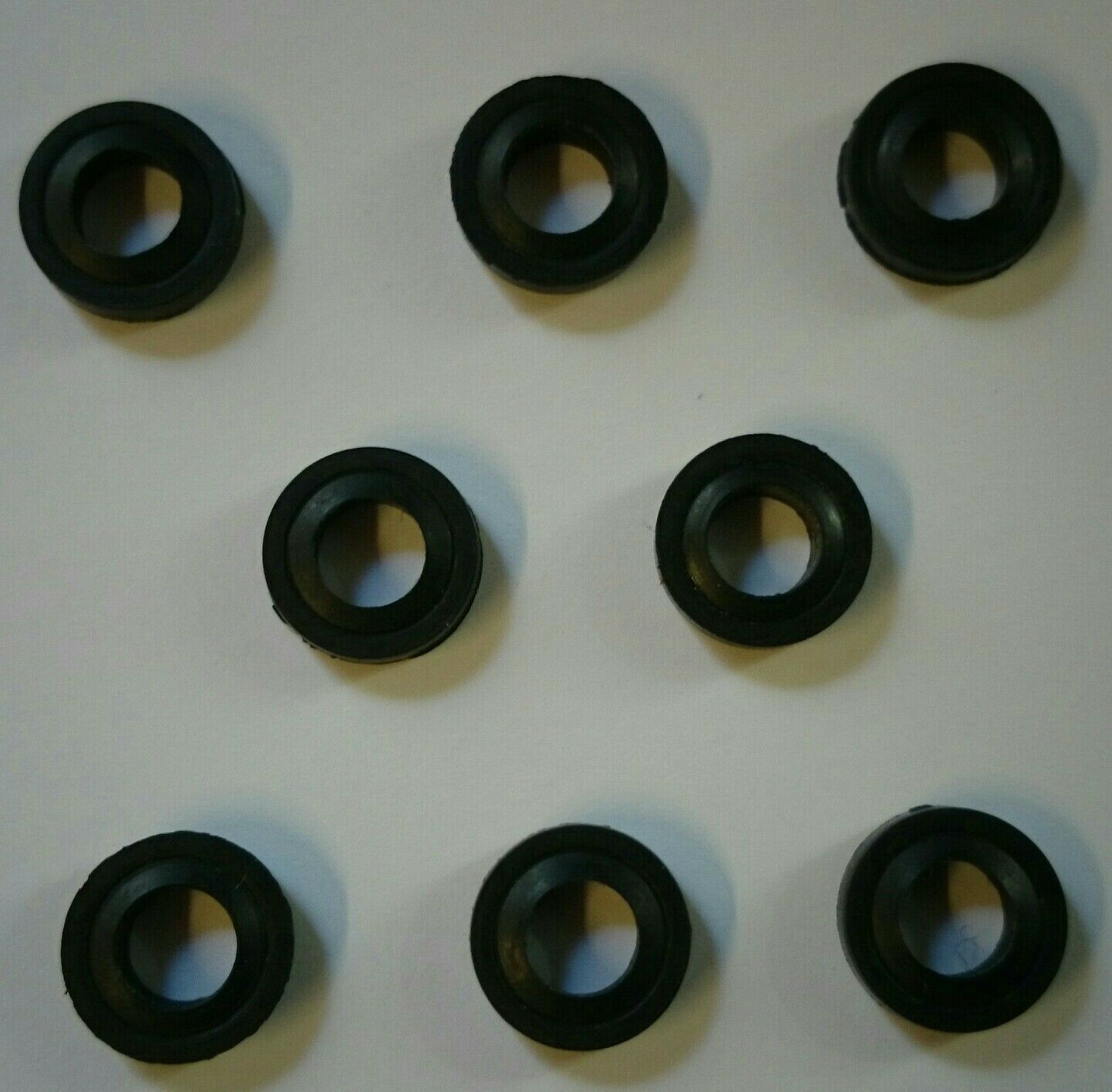

I've never had a problem receiving what I've ordered through Aliexpress.
I buy rocker box cover oil seals from Aliexpress, the seals have a 6mm bore x 14mm outside diameter x 5mm thick, so they are a great fit for the 1/4-20 screws on Sportster models, they are also fully encased in high temperature neoprene rubber. The cost to me is only £18.00 for 200 seals including shipping to the UK which takes about three weeks. That's only £0.09p per seal, H-D UK charge £2.34 for one of their seals, that's £18.72p for a set of eight.
I sell the fully encased seals on eBay at £5.00 for a set of eight including postage to UK addresses, unlike H-D's rubber and zinc plated seals these won't corrode due to their rubber encasement.
Here are the seals that I sell, they are high quality seals at a sensible price.
