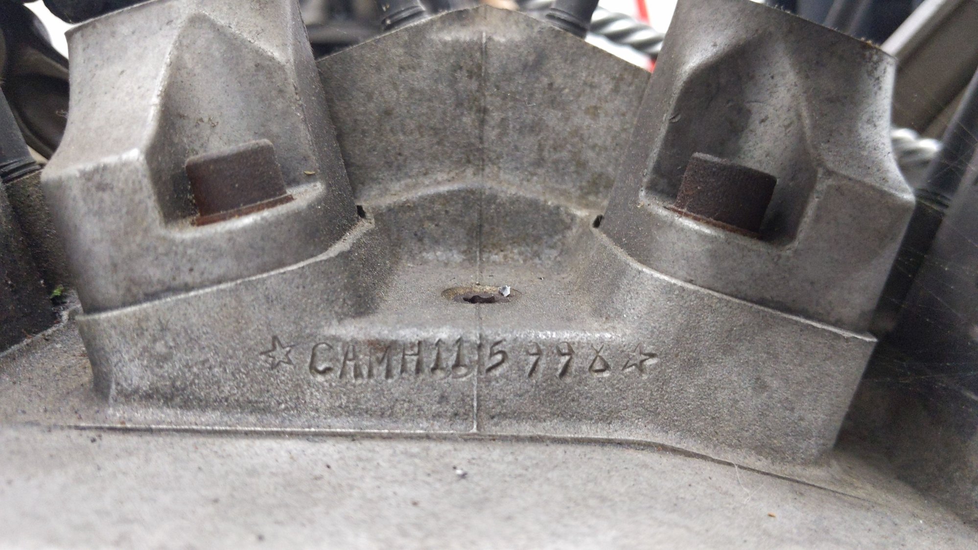

I purchased a Sportster a few years ago and it's been floating around my garage. While, I have a clean title for the VIN number on the frame, I've noticed there is an odd case VIN on what I believe to be a 1986 Sportster 1100. (Which is what the title says)
Case stamping seems to be a sadly lost knowledge base amongst most people. So, I figured I would try here.
Any help I could get, I would greatly appreciate. Thank you in advance

A picture posted up might help. Could just me casting numbers.

There is a picture attached to the post. If you were unable to see it I'll try and attach to a thread, here.

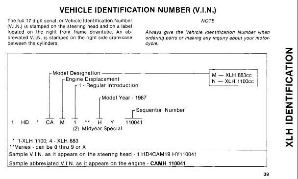

1987 883.
