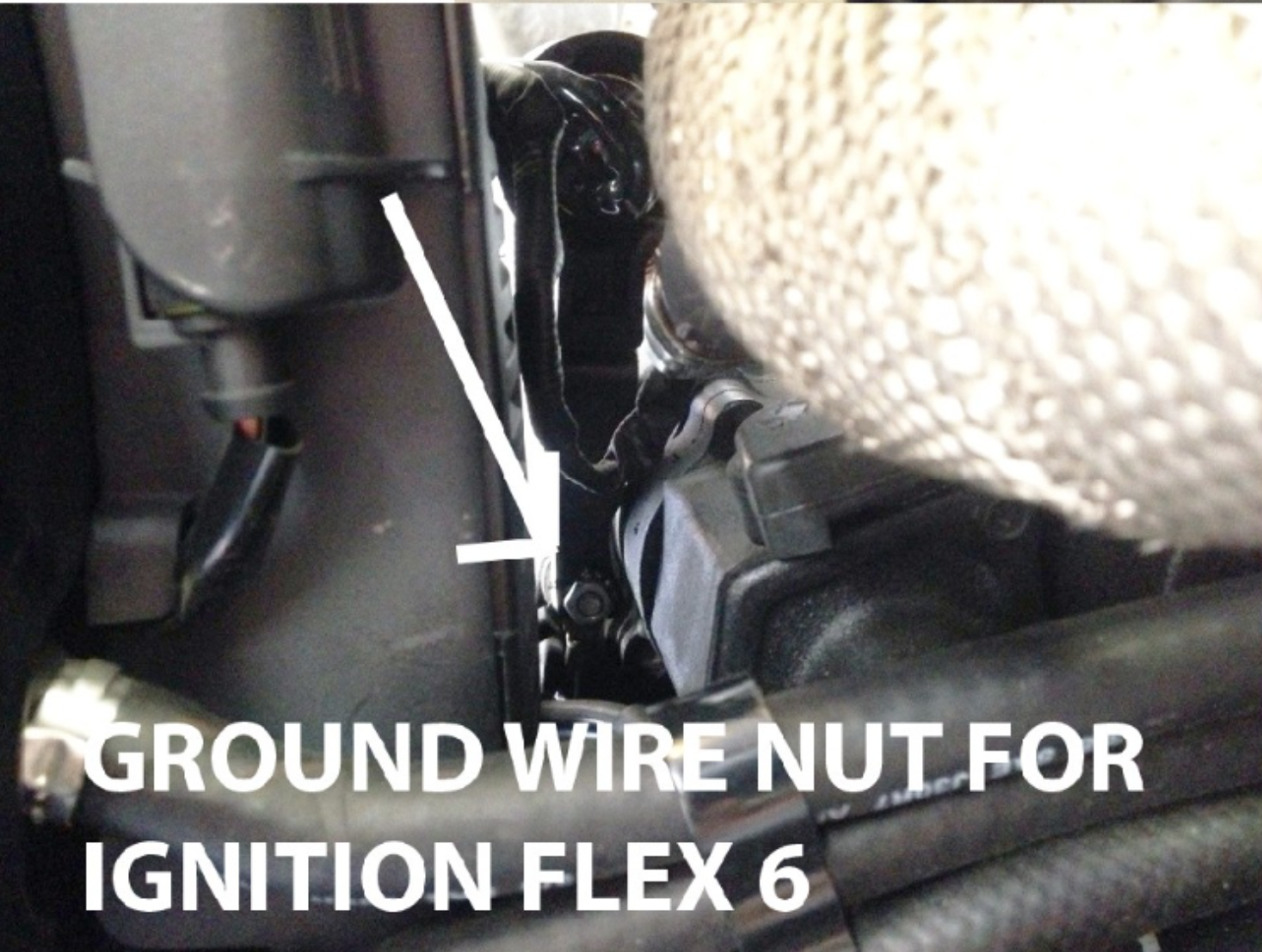

Hey all, installing a ignition relocation kit on an '18 48...dropped the ignition ground k lock nut into the abyss. Before I drag myself up to a dealership, does anyone know the size?
Pic for reference.

That looks like the ground at the back of the primary cover- found the crankcase diagram in the parts catalog
7792 NUT 1/4-20 X 1/4 (Grade 2)
2018 HARLEY-DAVIDSONŽ PARTS CATALOG: SPORTSTERŽ MODELS
If you search for the part number in the online parts catalog it shows the size of most of the fasteners in the "Hardware List"

I think you're correct--thank you so much!

I think you're correct, thank you!
