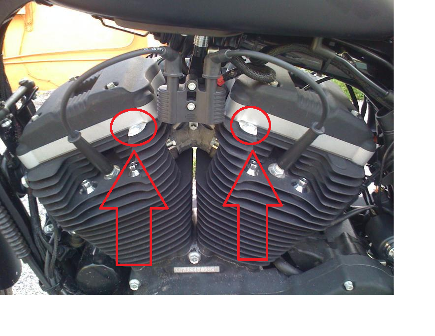

I need to replace one of the bolts show below as i've stripped the head.
Can anyone help me with what these bolts are called? So that I can search for some replacements?

After some more research I found this information.
OEM Part #: 4266A
or
SCREW 3/8-16 X 7/8 BUTTON HD

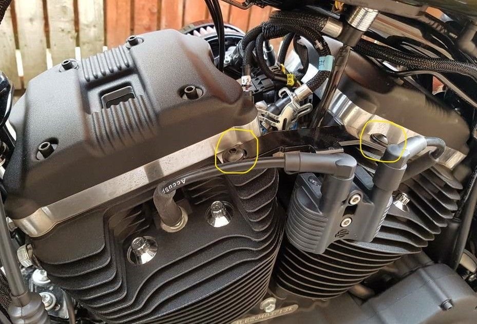

I supply those screws in black stainless steel to UK customers, I just call them "upper cylinder head screws", the stock screws are forever shaking loose due to vibration, they drop out and get lost on the road, especially after they've installed an ignition coil relocation bracket. The stock 7/8" screw simply isn't long enough to supprt a bracket so I sell 3/8-16 x 1" screws instead. I recommend smearing Loctite 243 ( the blue one ) on the threads before installing the screws, that will prevent them from working loose.
Here is one of my customers XL883N motor with an ignition coil relocation lit and my black stainless screws.
