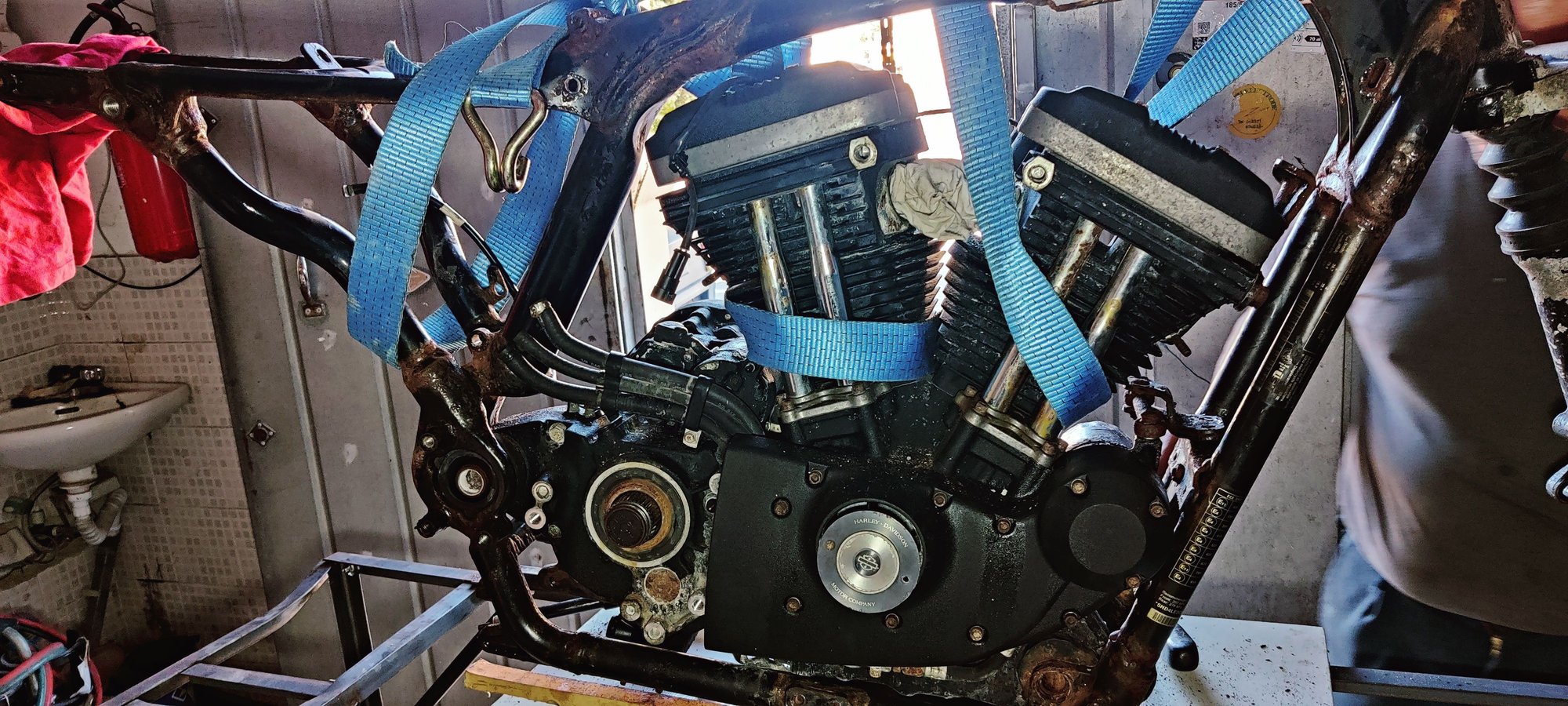

Originally Posted by Iron Horse 13
i can promise u that those engine mounts are done.u can get solid ones or replace the rubber ones
I would like a confortable ride so I will be replacing them with rubber.

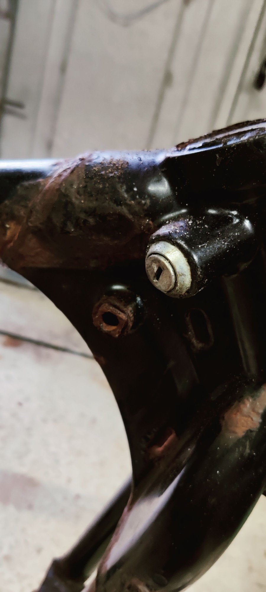

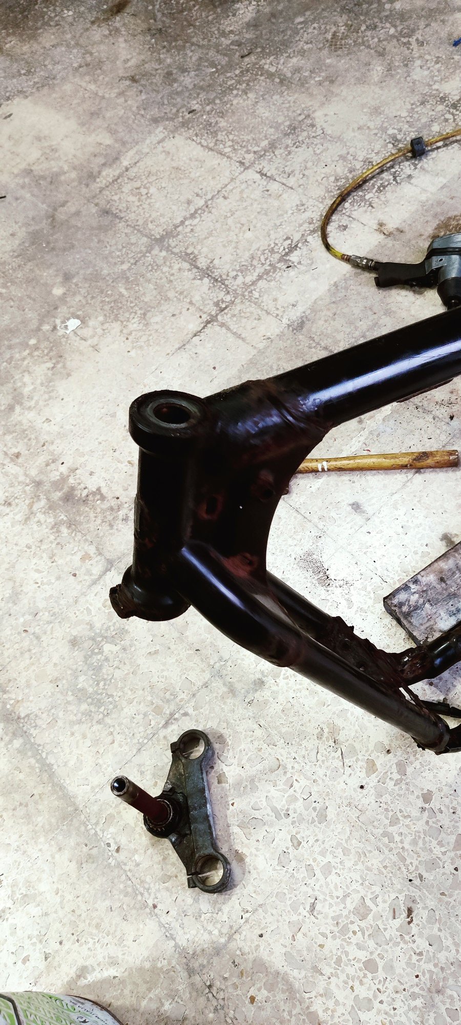

Any idea how I can remove this lock ?
Old Apr 26, 2022 | 02:19 PM
  #37
eighteight's Avatar
eighteight
Joined: Oct 2019
Posts: 10,751
Likes: 7,377
From: OH
^ A drill
^ A drill
There is a lock pin. Use a 5/64" drill to drill out the pin. See if you can centre punch it first to ensure drill stays centred. Use 5/64" screw extractor or similar to gently tap the pin out.

^ A drill
what do you mean, I just want to remove it so that I can do some work on the frame then use it again.
