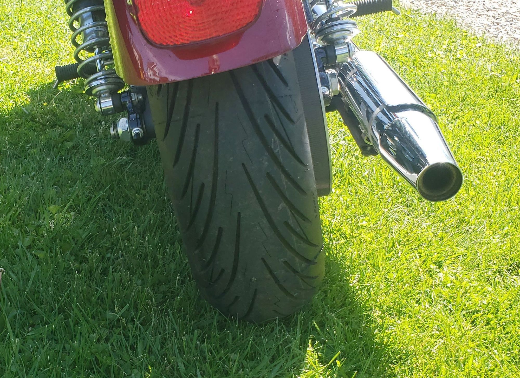

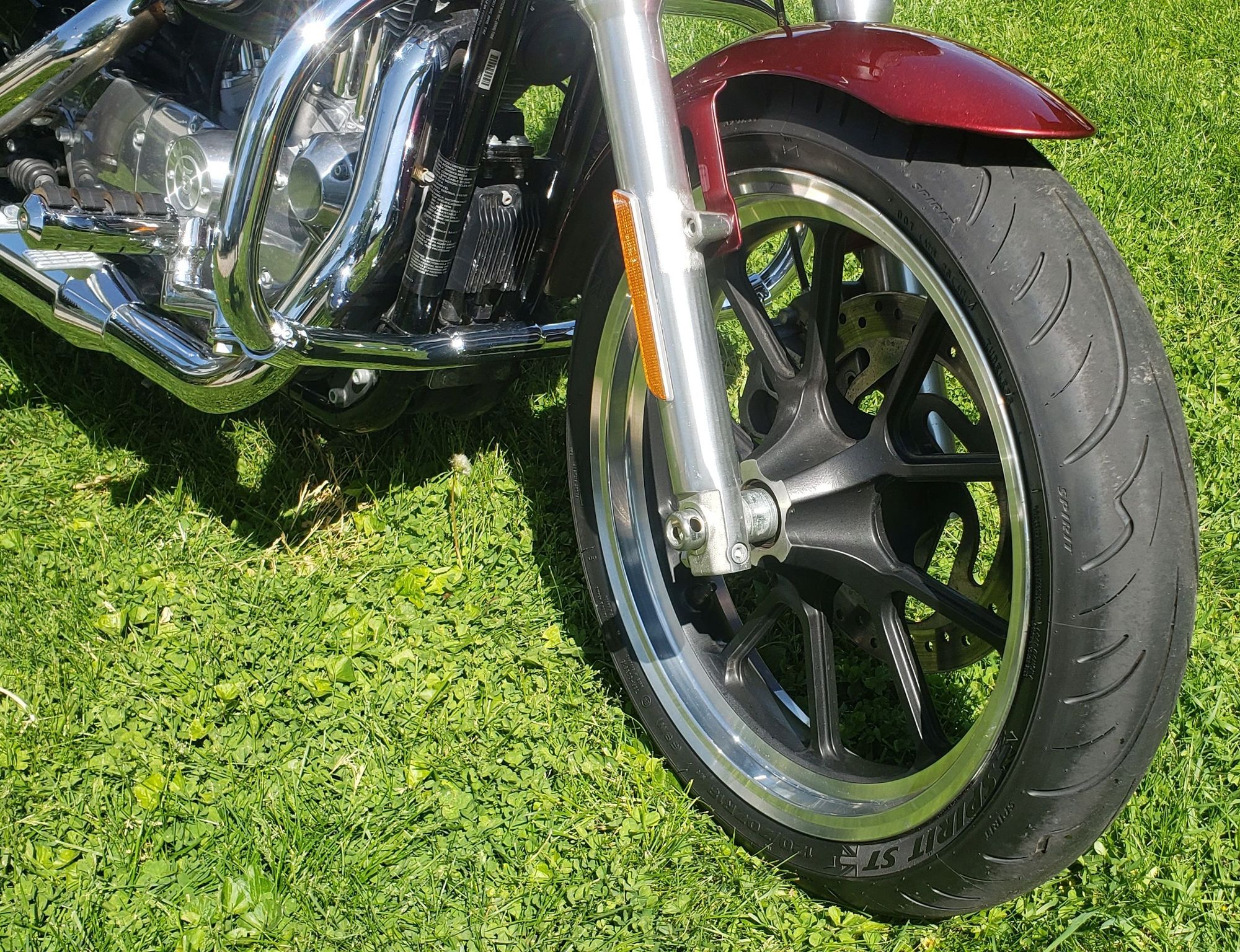

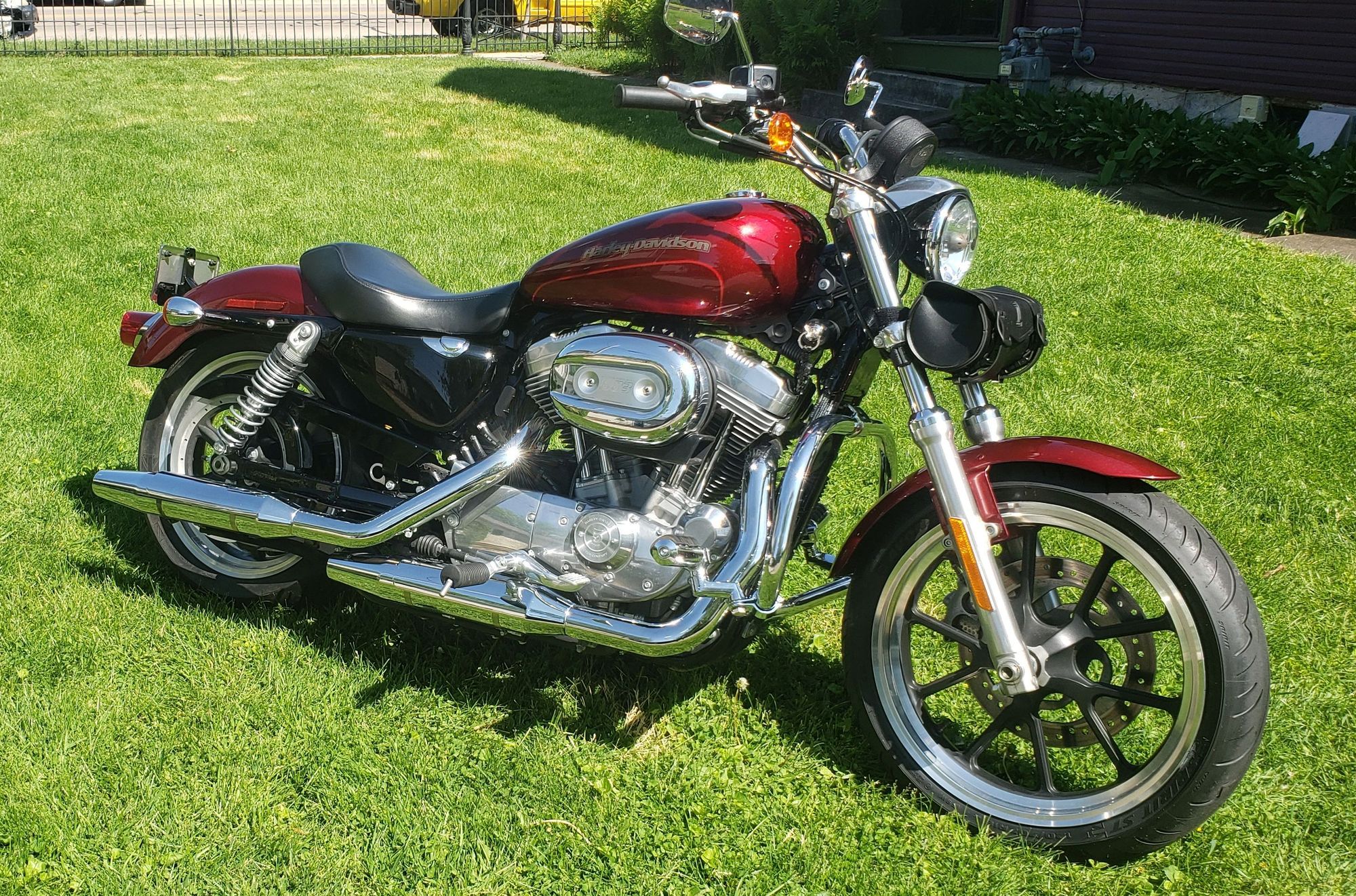

Avon ST's have been installed. I was very impressed with the initial balance of these tires. The original scorcher front used no weights and the ST was equally well made. A little adjustment to align it on the rim and I was able to get a very decent balance with no weights. The rear was a tight fit on width but has clearance. Balance was not as good but was still pretty close. I test rode with no extra added weights and found the ride to be very smooth up to about 65 MPH. Above that there was a minor buzz in the pegs and grips.
I had ordered balance beads but they had not arrived. at the point where I was ready to inflate. But when they did arrive I added the proscribed 1oz in the front and 2oz in the rear. I feel no difference up to 65 but the ride stays smooth on up from there with beads added.
Pics of Avon ST's installed
