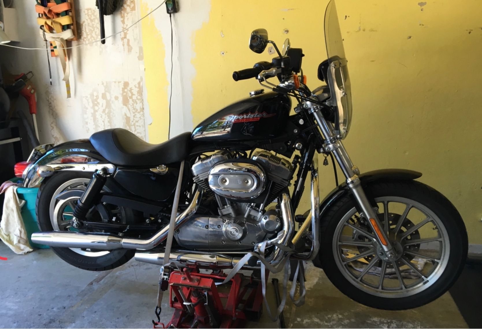

Here’s one in my garage getting ready for the switch

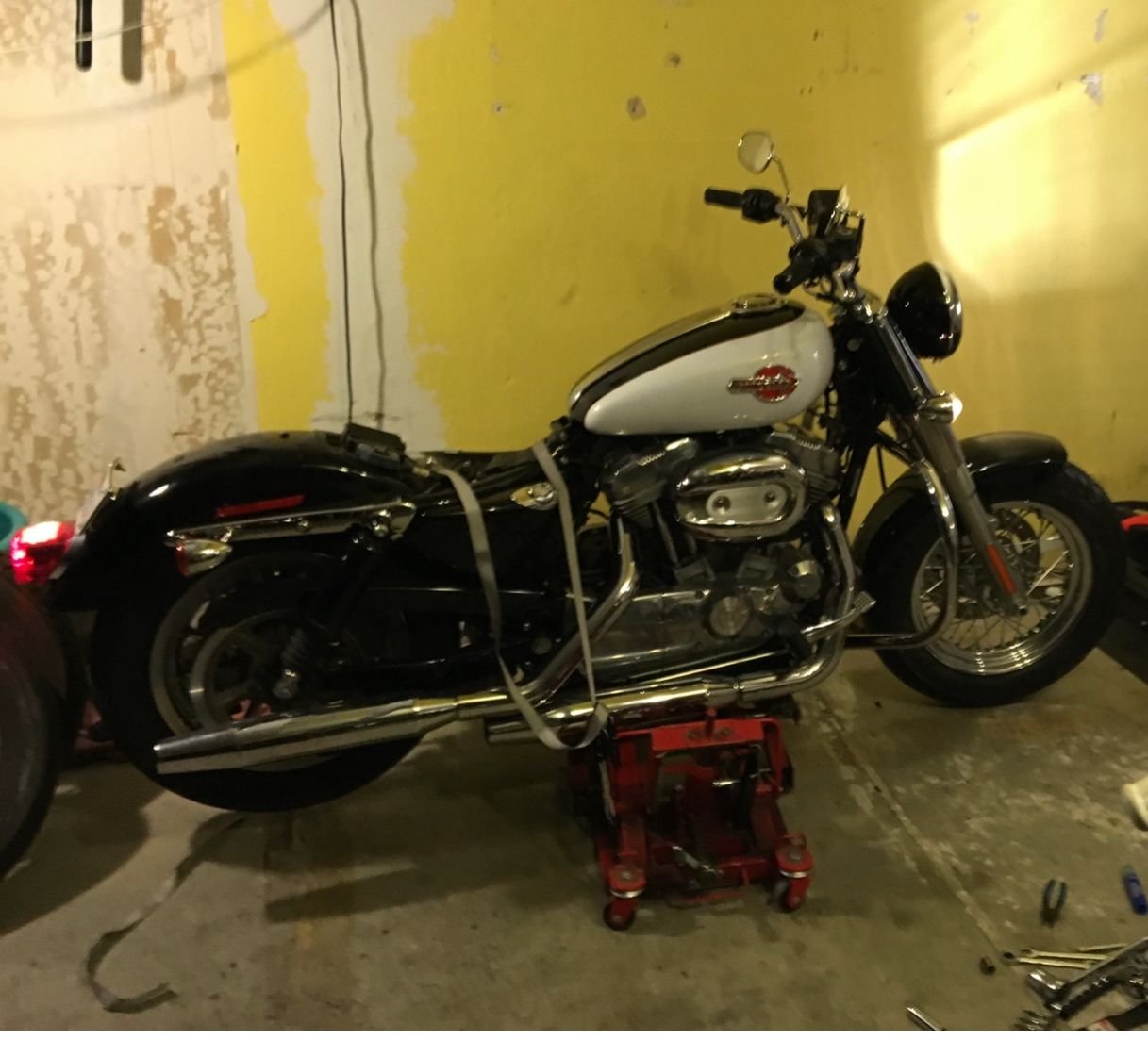

Here’s the same bike with a fat tank and a fat front end to match
