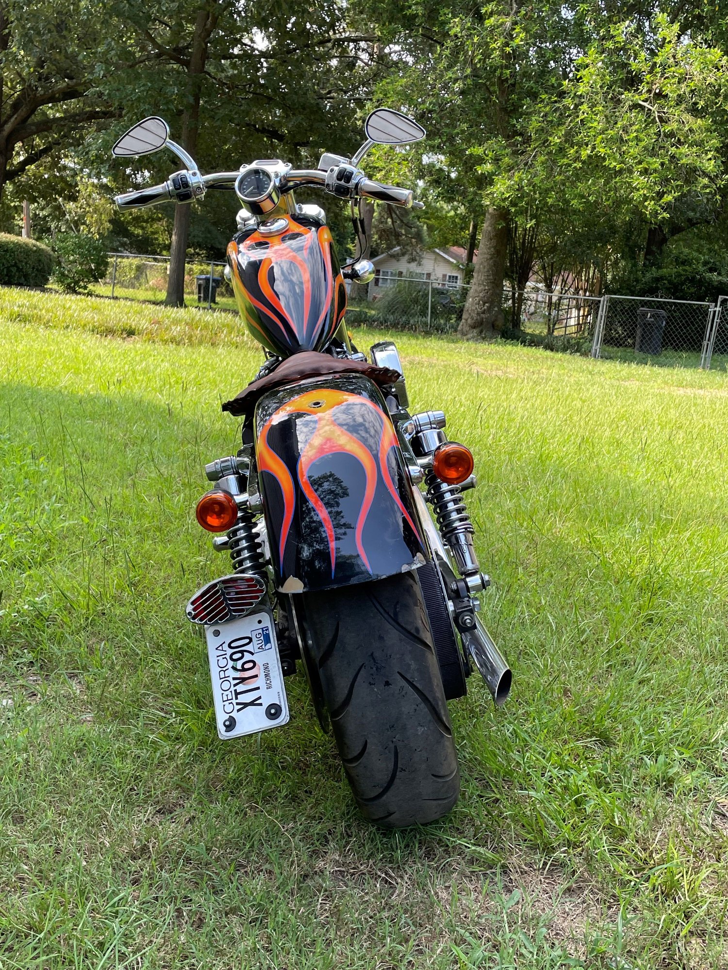

Original back tire with the 180/60R16 80H size.

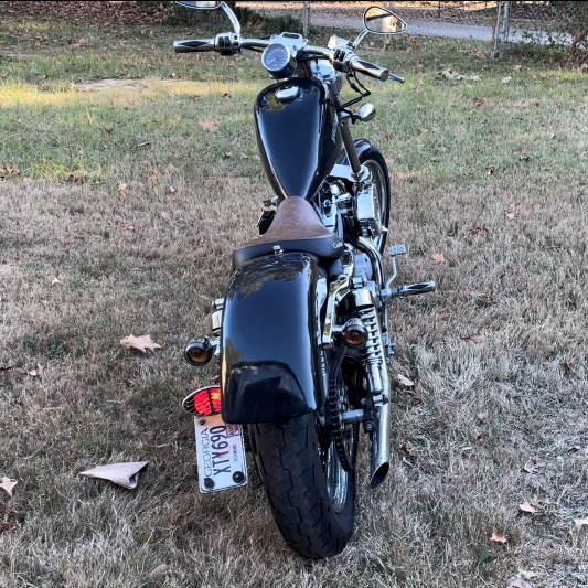

View from the rear with the new 130/90 B16 M/C 73H tire

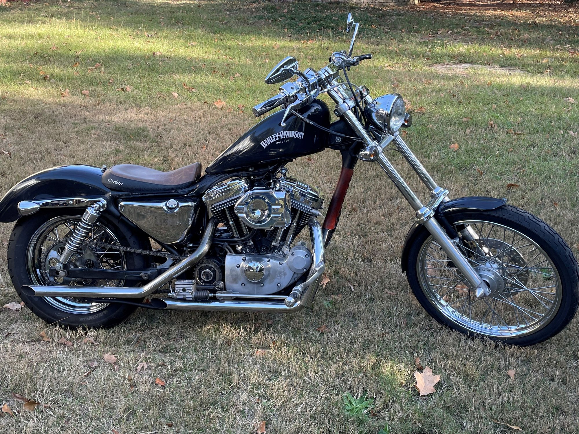

side view of the bike with the new rear wheel and tire.
I trying to see if I need to order a new wheel to get back to the wider tire again or was the dealership probably going by what the manual said.

You could measure the wheel width on the 180 size tire, but definitely you'll have to go wider. Depending on the tire profile usually 4.5" - 5.5" wheel width will take the 180 tire.
Looks like you went from belt drive to chain. You also have the same swing arm as on the 180 tire?

On a 2017 Custom that has 150/80B16 Michelin Scorcher "31" tyres the rim is T16 x 3.00 D.
On a XL 1200X the tyre is again Michelin but the rim is E16 x 3.00 MT
The same rim is used on the front with the 130/90B16 tyre.

So theoretically I could go to the 150/80B16 tire on the 16x3.00 poked rim I have. I did change it from belt to chain. I already have 4 or 5 different offset sprokets for the front. So the rear offset I would have to get to compensate the difference.

That is not a 180 tire in the first pic. 180 won’t fit that rim size, fender, swingarm ect
