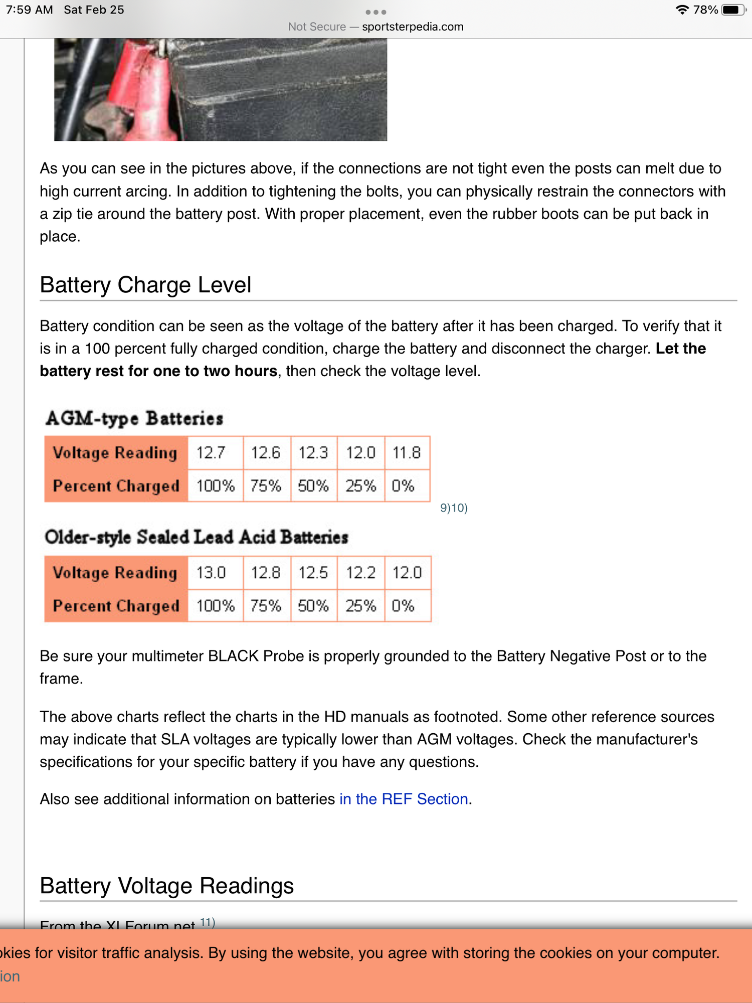

Actually 12.6 volts is about 75% charged, not dead. Yes, I did charge the new battery. And yes, I keep them on a smart battery maintainer. I do not have a maintainer on this battery because it’s only 4 days old and I’m in the process of working on the bike. I do appreciate your help and insights, though. Thank you.

Here’s a screen shot from Sportsterpedia website about battery life.
