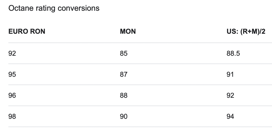

Chart just for reference, as this forum is very international.
So, 125cc bike ran 92th petrol without any issues, sometimes I was feeding it with 95th.
Now 1200cc EFI Sportster eats 98th, so 95 is also acceptable.
Never ever I had to put any additions into fuel, except 2T oil when I rode a two-smoker.
