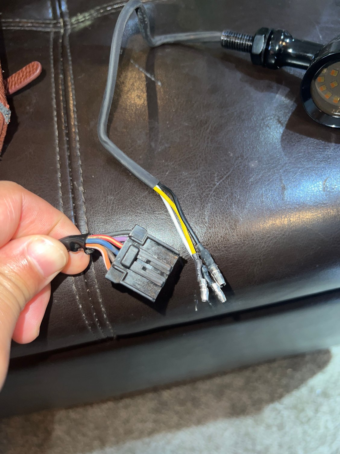

Old subject, I’m sure. I chopped my rear fender. Have rear lighting cable, but instead of single brake lights these will be dual.
which color on harness is brake light and which is turn signal? Which is running ligjt?
on new ones, black is brake light, yellow is turn signal and white is running ligjt. I’ve searched YouTube, but mine is 2002.

blue is running light and purple are turn signals. If you’re unsure just get a test light and hit turn signals and check for brake lights/running lights.

I believe purple is left turn and brown is right turn.

Sorry, I’m new to all this, but yes.. yes! Have bike one and test signal when I do brake, signals, etc.
thank you!

Wiring diagram here - https://serviceinfo.harley-davidson....nContent=false
If you want to remove the single central brake / tail light and use the indicators for that job then you will need a module that converts lighting signals into run / stop / turn as seen on the newer Iron model.
This kind of thing - https://www.customdynamics.com/motor...ersion-modules
I see you have a led light. The 2002 is not designed for that so you will need the module or load balancers for the indicators as a minimum.

Would I have to do that even if these replacement LEDs have separate break, running light, ground and turn signal leads?
I did purchase the resistors for the turn signals.

Purple- signals
Red/ Blue- brake & running (not sure which is which) Brown/ Orange- what could they be for? L Plate?

What is that jumper for? The wire between the turn signal plugs.
Orange/white stripe is main power
Purple is left turn.
Brown is right turn
Red/yellow may be brake signal.
Not sure about blue
