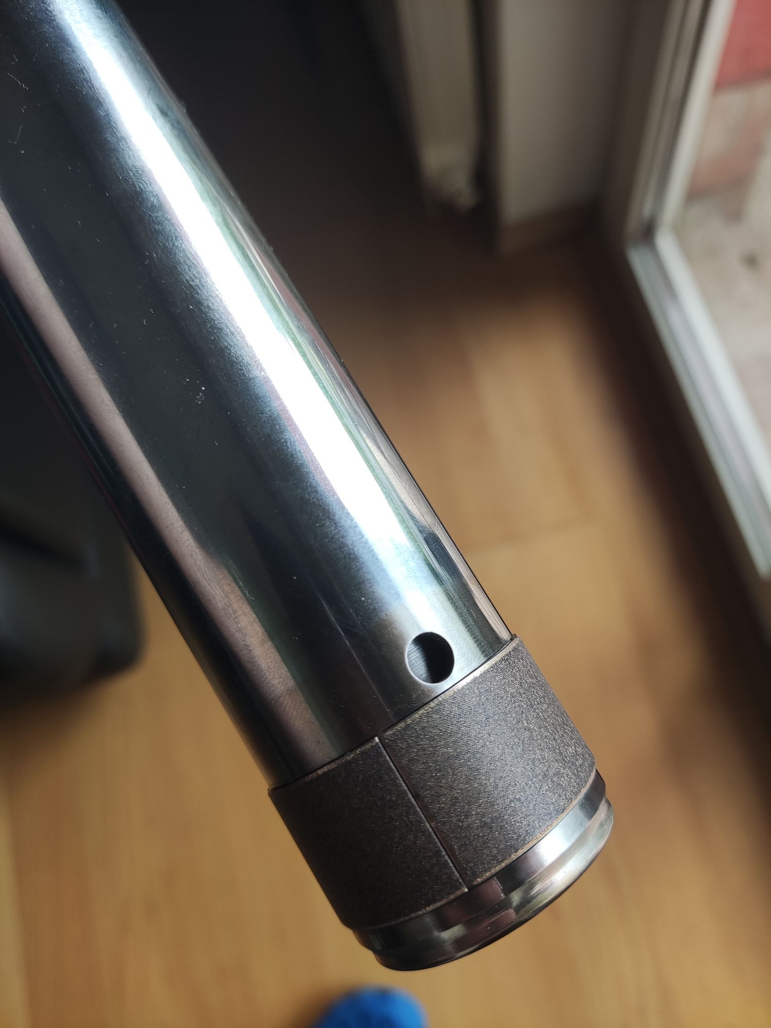

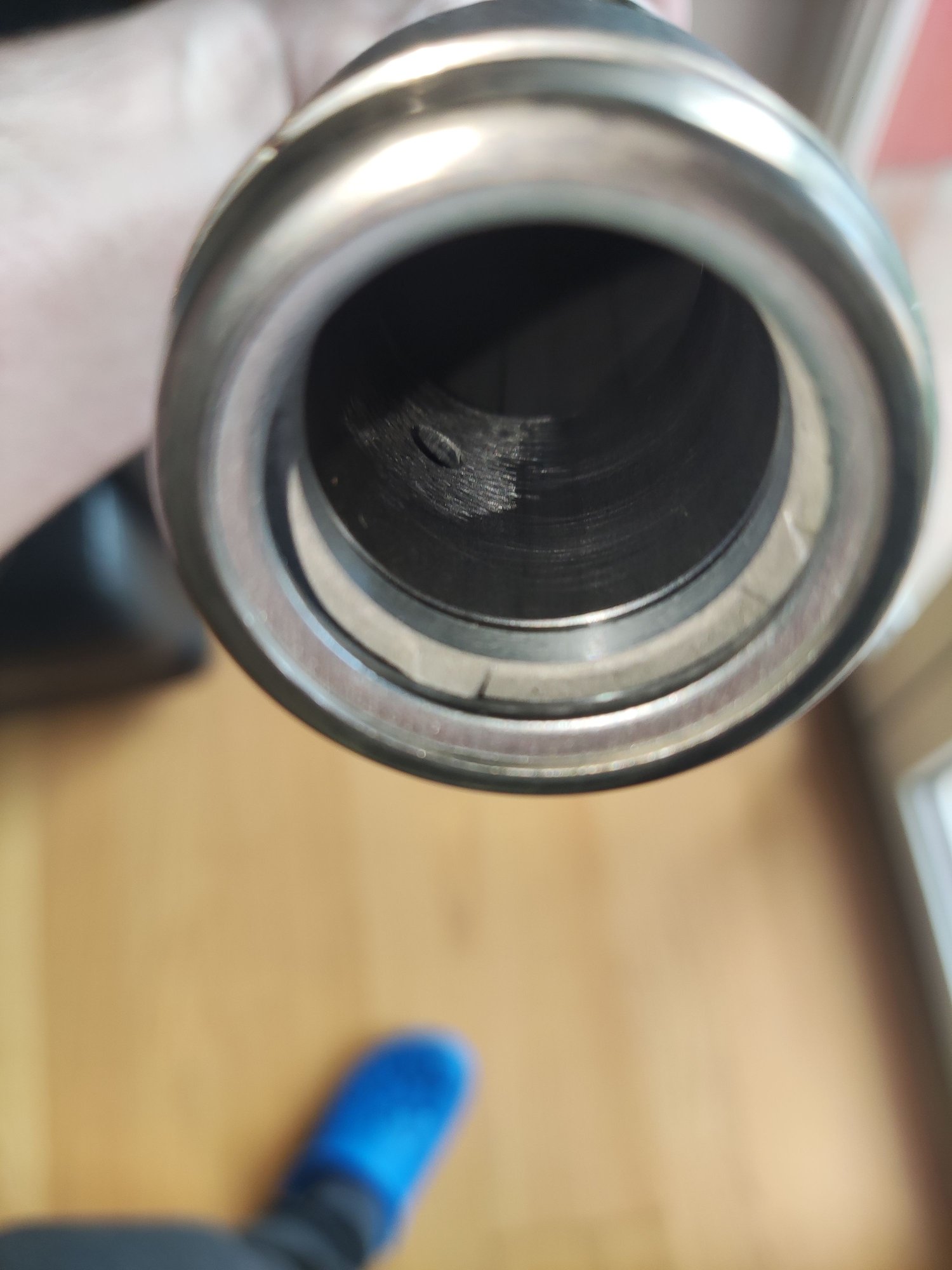

I bought screamin eagle fork and noticed on one of the fork tubes bottom holes are open on other is closed.(two holes at the bottom of the tubes.) Looks like the inner holes are not aligned with outer holes.is that normal?what are this holes for?

The holes could have been used for suspending the tubes in the chromium plating tank, that would also account for why they aren't aligned, they won't serve any purpose after the tubes have been chromed.

I didnt mean holes in dampers i mean holes on bottom of the fork tubes.
