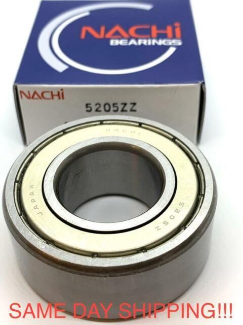

Nachi bearing # 5205 is 21w x 52od x 25id

I see the 20.6. Not 21. Will this work?

^ Yes.

Go with the HD solution if in doubt. Putting in the spacer will put the primary bearing in the correct position and I assume from that other thread I linked the inner wheel spacer is 6mm longer such that it puts the second bearing in the right place.
HD probably went this route for what they supply which is 15mm wide bearings.

The H-D part 9276B is a double metal encased type, they are manufactured in South Korea.
The equivalent bearing number for 9276B is 5205ZZ, all bearing manufacturers will use that reference number. Instead of paying H-D stealership prices, try your local bearing factors, most towns and cities have at least one bearing factors supplier.
The 20.6mm width of the bearing is actually 13/16", that is the same width as the stock H-D bearing, 21mm is incorrect for the width, it looks like someone has rounded up to the nearest millimetre.
