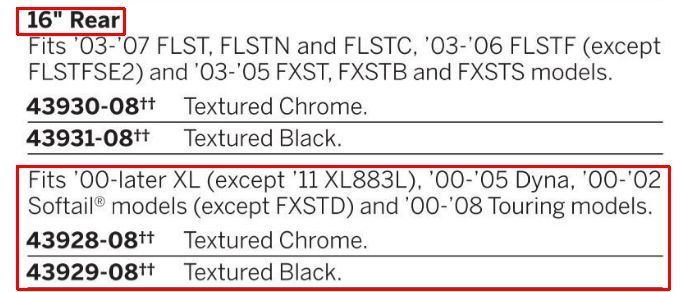

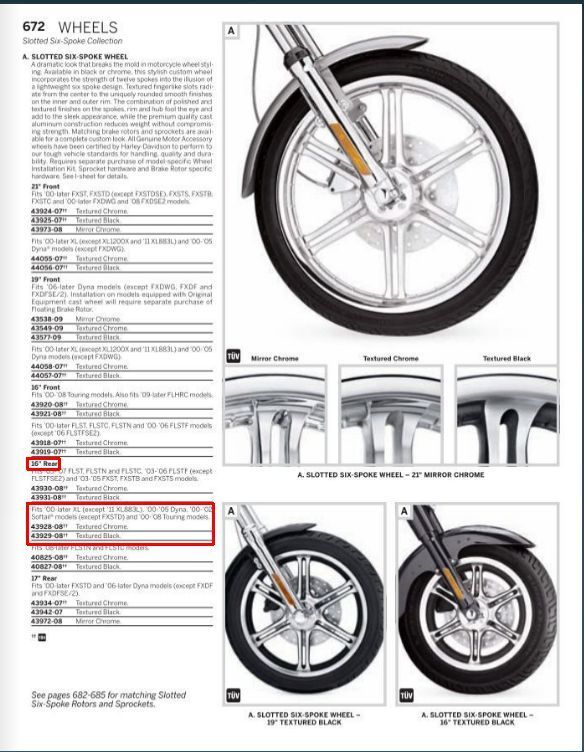

YES ... Simple and Easy. Use (1) proper sized bearing shim Harley offers under the Rotor side bearing and the 2008 center spacer sleeve (you can reuse your original 08 1200C or buy another)
That is how Harley can offer a Single Part# Rear wheel that covers multiple years ... including the ones in question.
See Example Below for "00-later" Sportster 16" rear wheel sold through Harley "Parts and Accessories" (old catalog)
