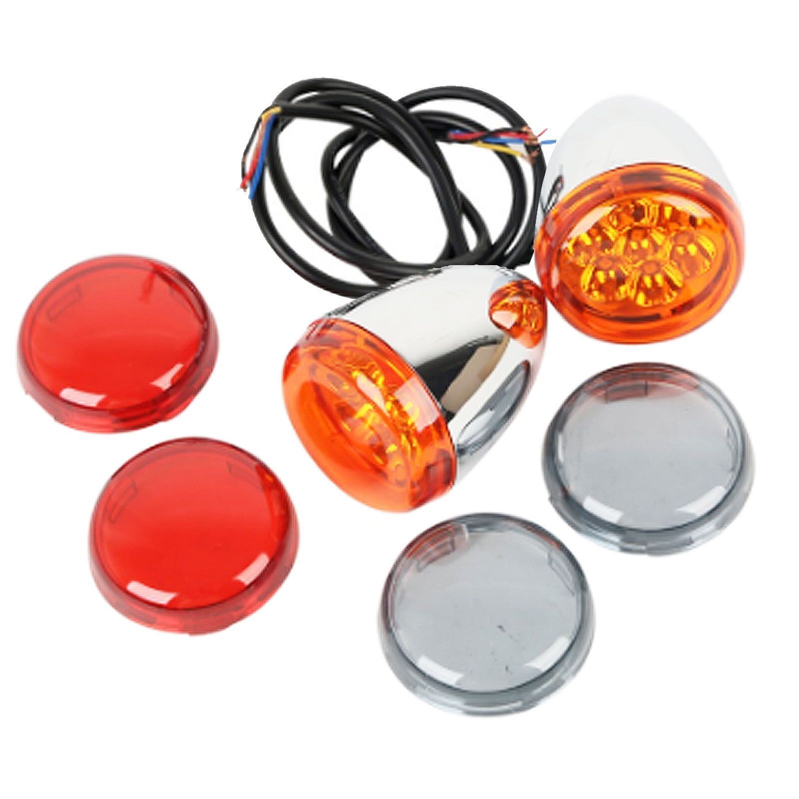

3/ Swap both of the domestic indicators for LED units as below, you will need to install voltage equalisers for the LED lights.
