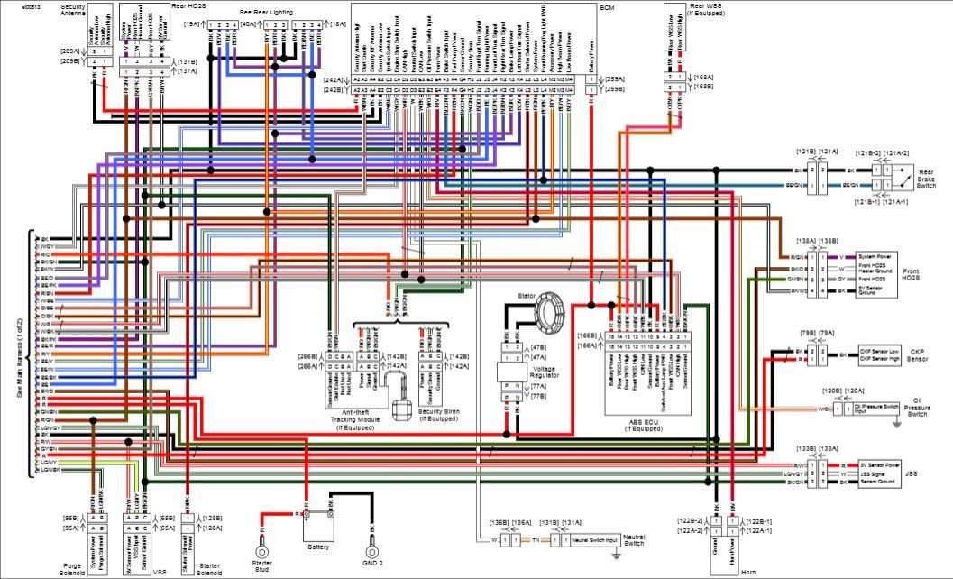

Originally Posted by RANGER73
You're mistaken I believe.
Is the ignition off when this happens?
There's a starter relay of some sort somewhere, you need to find it.
There is no starter relay on any Harley with a Body Control Module.
By 2017 all Harleys had the Body Control Module.

Old Sep 6, 2023 | 09:54 PM
RANGER73's Avatar
RANGER73
Joined: Sep 2010
Posts: 15,430
Likes: 7,124
From: Beyond Fucital
Oh well, I tried. That's the diagram I got when I GOOGLED it.

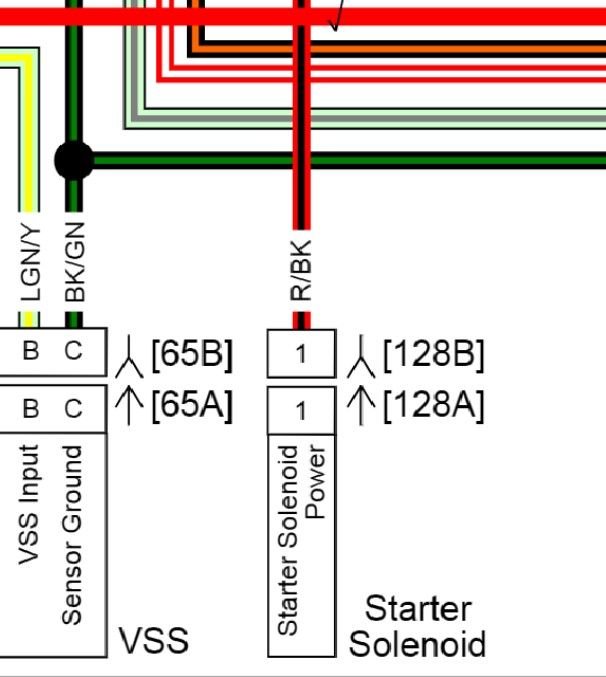

Heritage_Luke's Avatar
Heritage_Luke
6th Gear
Joined: Sep 2023
Posts: 12
From: detroit
When I disconnect the plug at the starter (red/black wire) it does not crank. I tested that plug today with a multimeter and it’s reading 12.4v at all times. My buddy with same bike (2014) his sits at 0.1v until his ignition is switched on, run switch set to on, and the start button is pressed; then it jumps to 12v. Once released it drops back down.
unplugging the right hand control module would be the best way to test it but I can’t find the SOB. I probably will have to drain the fuel tank and take the tank off. I was hoping to not disassemble too much in fear of not having time to get back to it right away. it’s not my daily rider.
I’ll update you all when I can
