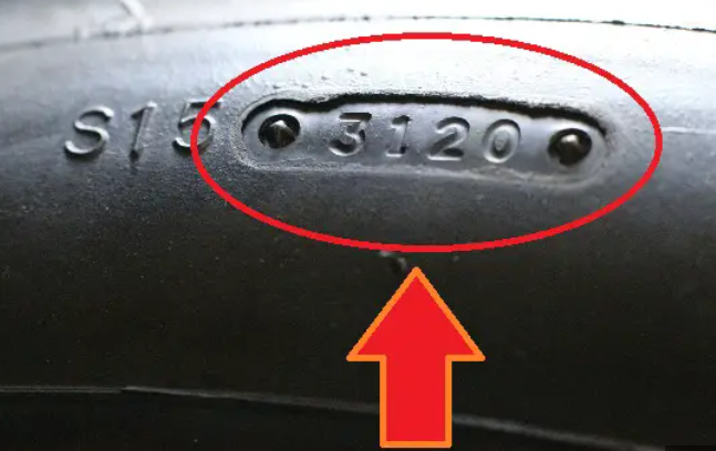

I would check the code date on the tires. If the tires are more than 7 or 8 years old I would get some new rubber. Some on here will say 5 years is the max but if you do your research many tire manufacturers say 7 to 10 years is ok.
Look on the sidewall of the tire, there will be a 4 digit number with a circle around it. The first two numbers are the week and the last two are the year the tire was produced. For example, the tire below was created in the 31st week of 2020.

Thanks for suggesting this. I looked at the tires visually and they looked ok but let me check and make sure that are not significantly old…
