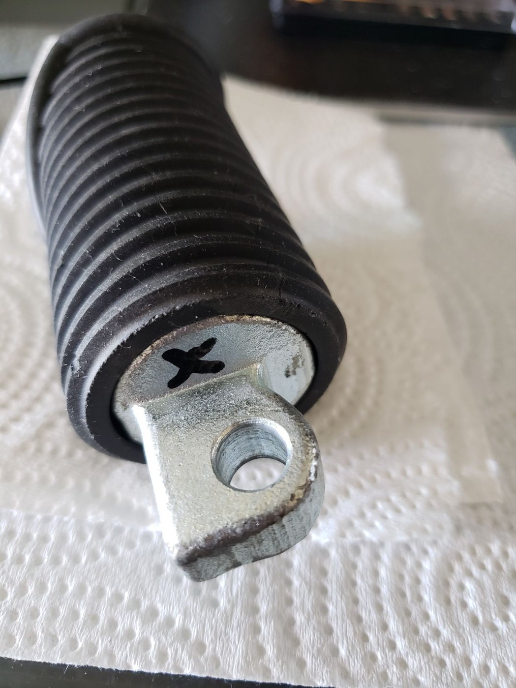

From: Arizona
These H-D anti-vibe style pegs will move your foot in a good inch, but also forward an inch if they fit the 48 clevis. I have some that I'll look for and if I find them I'll see if they'll fit. I like the idea of having my foot an inch closer to the shifter also.
Old Oct 14, 2023 | 02:57 PM
snatchcat's Avatar
snatchcat
Joined: Feb 2014
Posts: 607
Likes: 243
From: Arizona
Because of how the clevis is longer on the 48 forward side you would need to grind a little divot about 1/16" deep where I marked with the X, otherwise they will work. They are about $40 a pair more or less.
