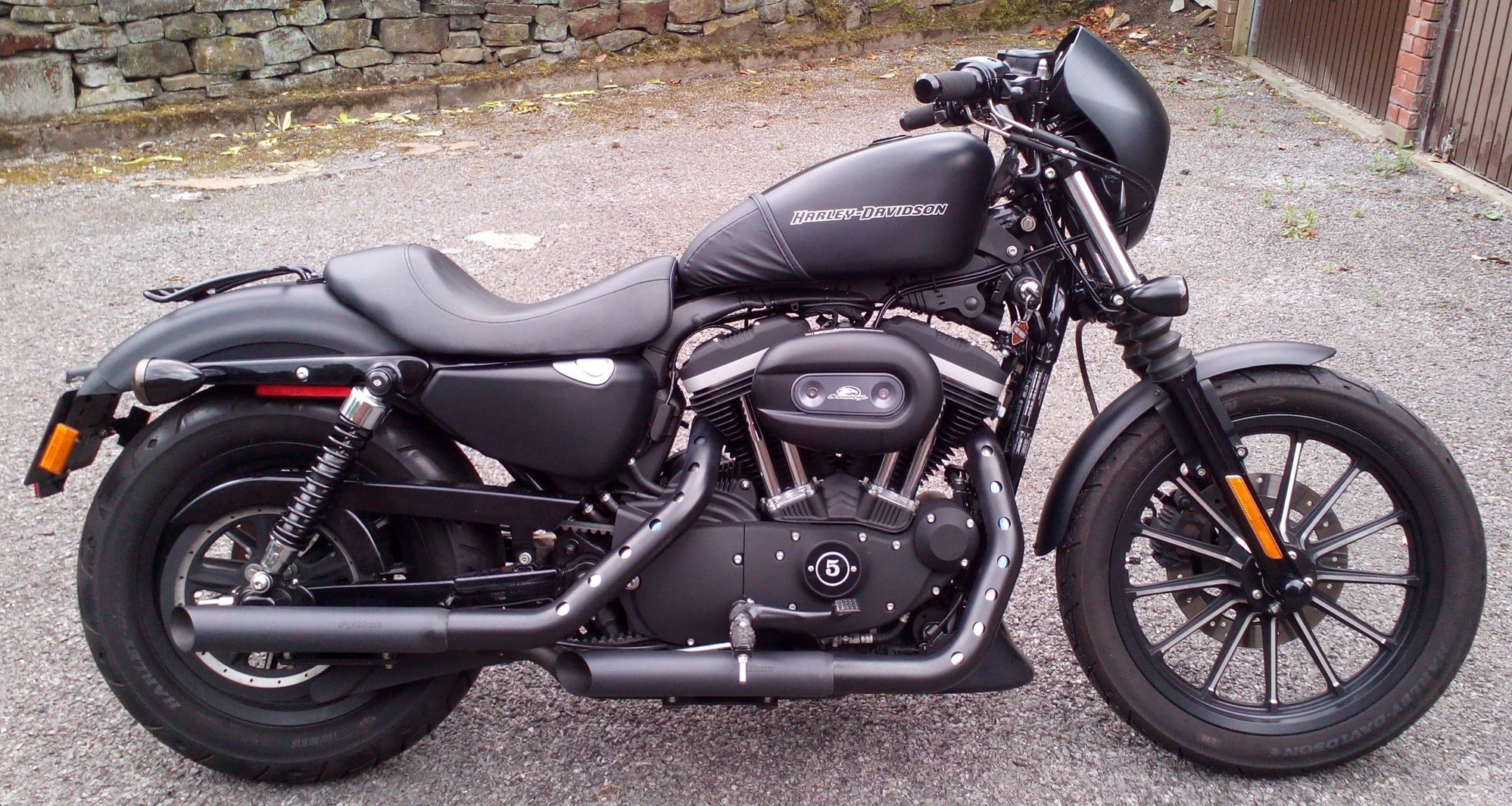

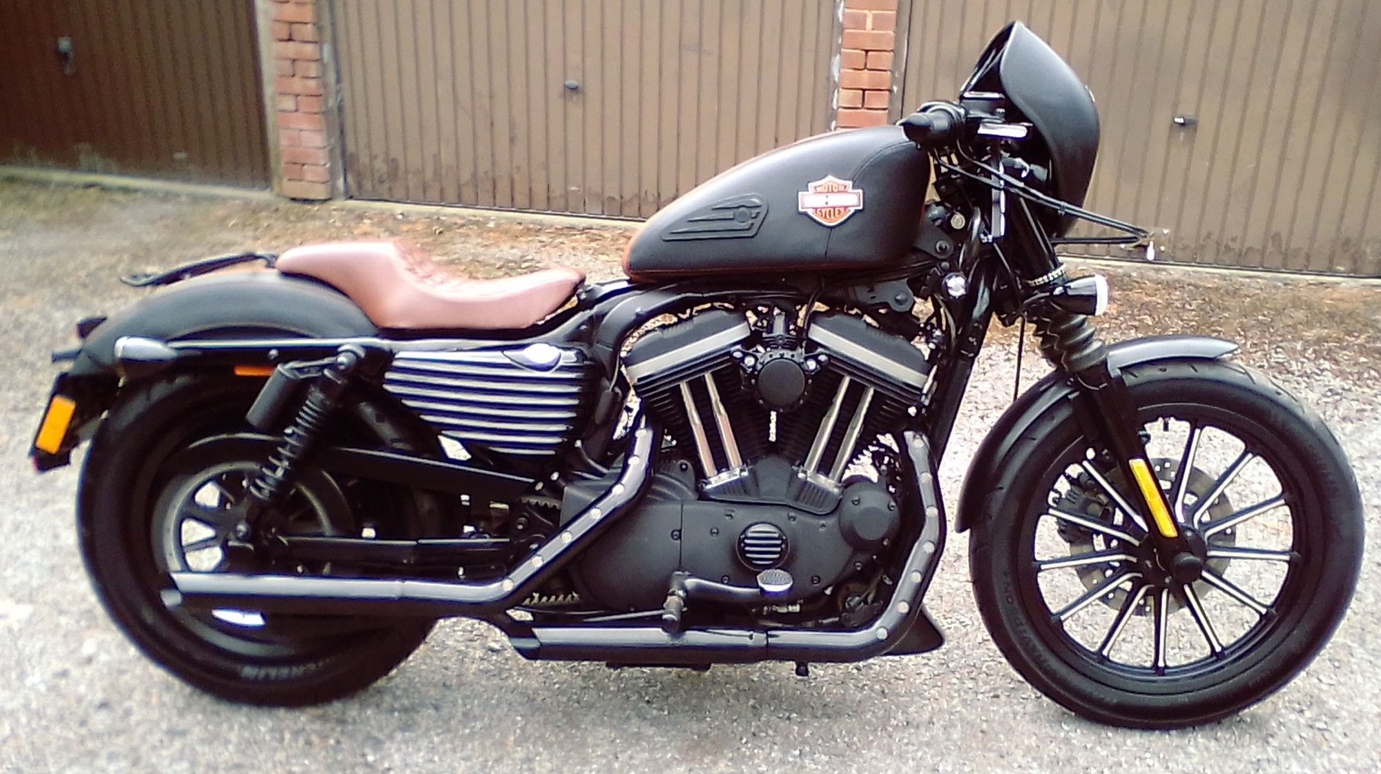

My Python slip-on mufflers were black ceramic coated from new, the coating was a matt finish but after seven years the coating was starting to come off and the mufflers were showing spots of rust. I had them powder coated with a gloss high temperature resistant powder in 2019, the coating is holding up well after four years so far, I also had the header pipe heat shields done at the same time so that the match the mufflers. It cost me Ł60.00 to have the powder coating done, I think t was a cost effective solution compared to having them ceramic coated again.
Ceramic coated.
Powder coated.
Ceramic coated.
Powder coated.
Powder coat looks better than the ceramic IMO.

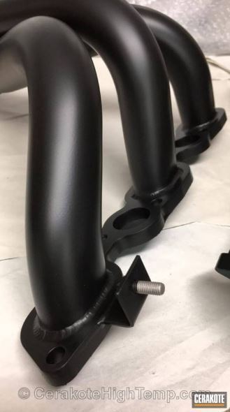

For anyone interested in powdercoating their exhaust, I would suggest Cerakote high temp ceramic coating for exhaust. The glacier black looks gorgeous. In my opinion the quality and look of the finish is much better than the general powder coatings used.
